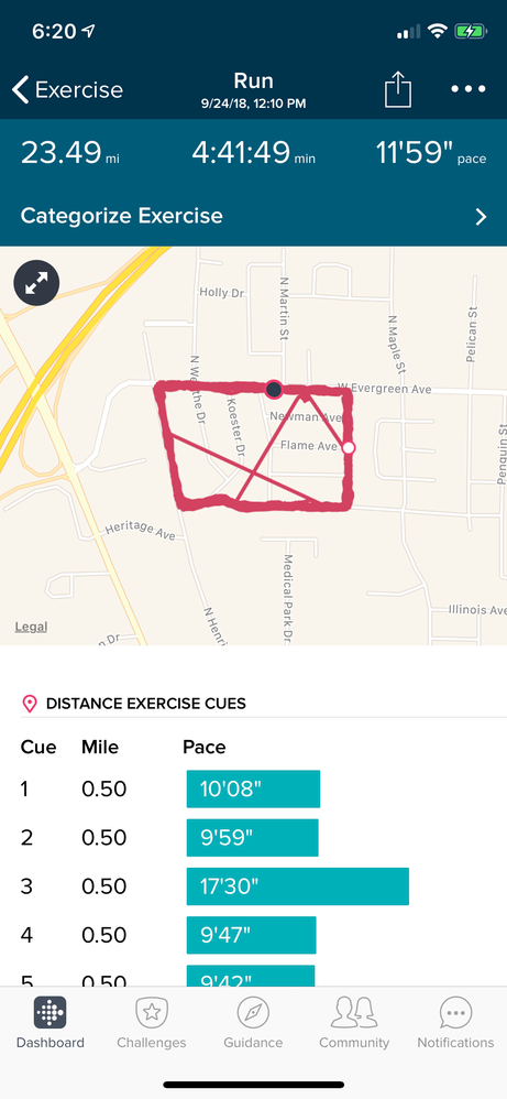

Hey all,
I wanted to help shine some light on this subject.  After doing a number of 25 to 35 mile runs, I feel I can give a fairly accurate answer.   Playing Music that has been downloaded to the watch itself (not streaming) and using GPS to track my runs from a FULL charge... will usually last between 4.5 to 5 hours.  This is with notifications every .5 miles.  If that even matters.  I have ran over 5 hours five different times and it never once lasted longer than 5 hours before it ran completely dead.
Hope this helps.
Bryan
