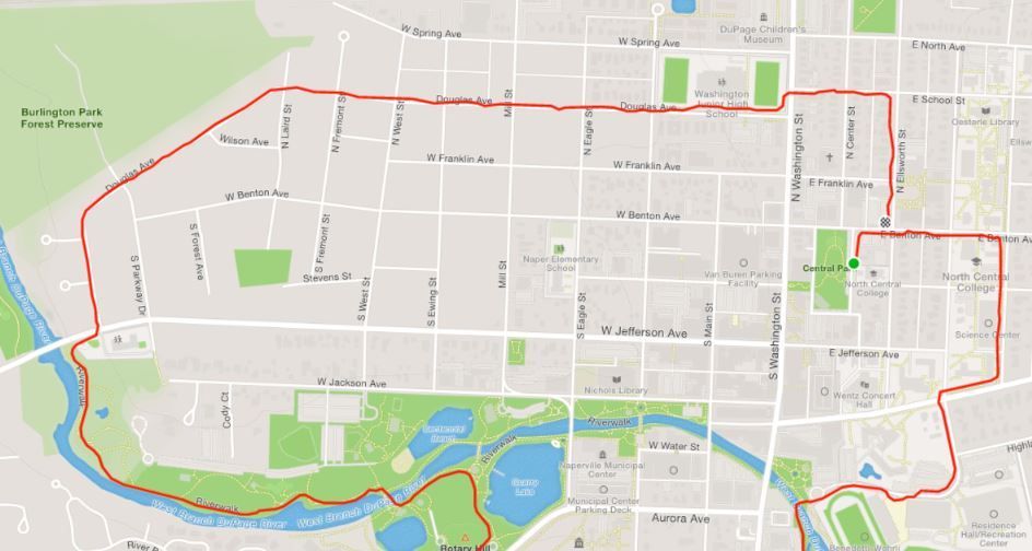

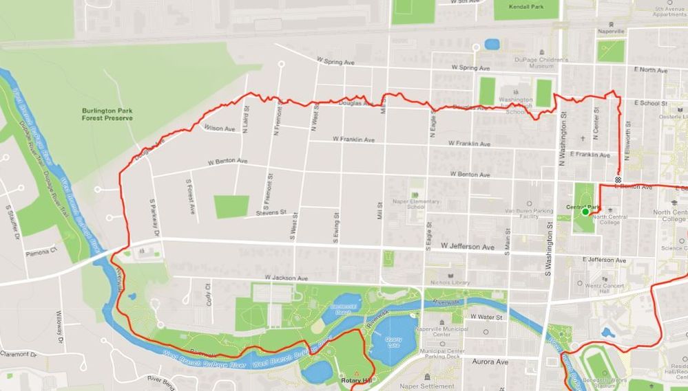

Same issue here. It's been reported on another thread. Oddly enough on my run last night, I tracked it with both Fitbit and my phone. Fitbit did pretty well for the first 45 minutes or so, then became erratic.You can see the comparison of the maps below. This added about another quarter mile or so to my run, and also changed my average pace. This never happened before the last update, when the Ionic was a very reliable device for tracking my runs and bike rides.  tracked with the phone, nice smooth lines toward the end of the runtracked with the phone, nice smooth lines toward the end of the runtracked with fitbit, was fine until the end, then became erratictracked with fitbit, was fine until the end, then became erratic
