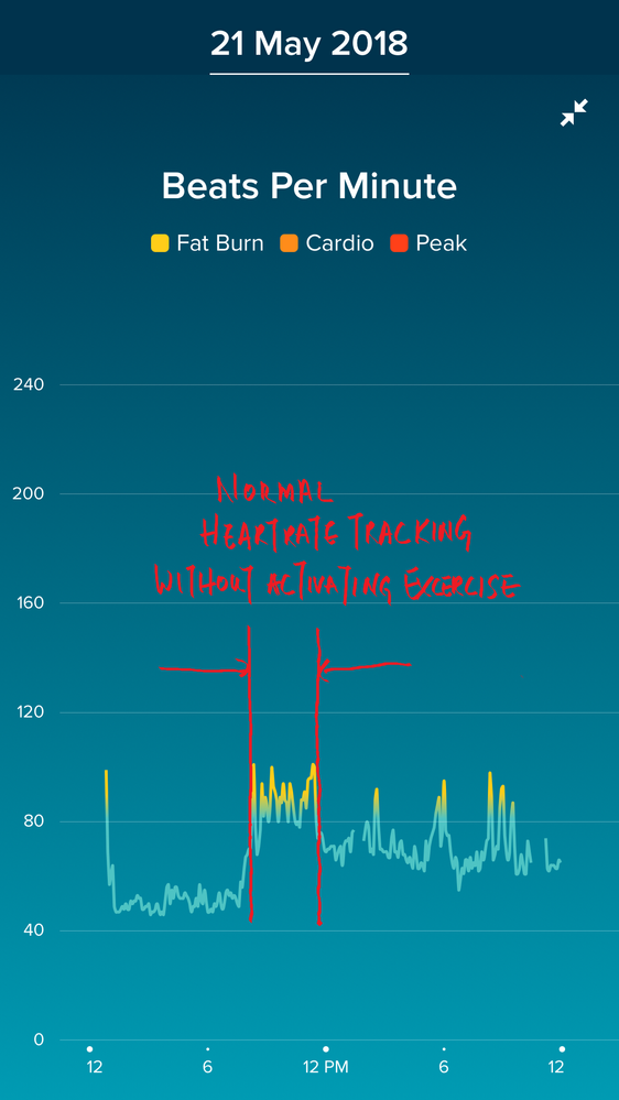

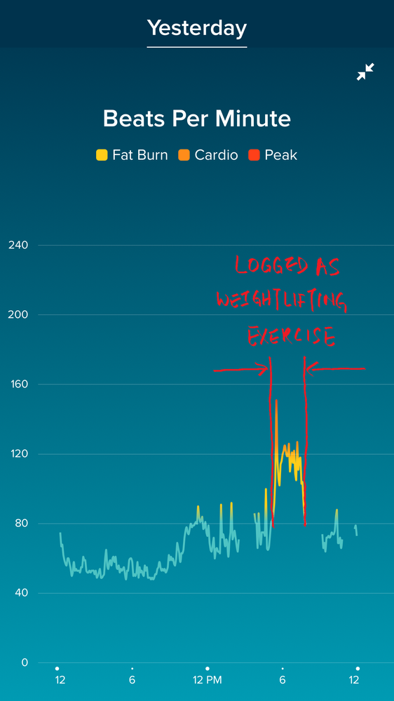

One problem I can reproduce every time with my Ionic is the inaccuracy WHEN the exercise mode ("weights" mode in particular) is activated.
I follow a fixed routine to do my weightlifting once every two days. Whenever I turn on the exercise "weights" mode to track this activity, the heart rate is consistently 20 - 30 bpm higher than when I just let my watch track my HR during the same activity like usual without activating anything.
Case in point:
Weight lifting WITH exercise mode turned on
Weightlifting WITHOUT exercise mode turned on
The difference is pretty obvious right? Keep in mind I do basically the same thing, and I can reproduce this behavior with the Ionic everytime.
It seems to me that the Ionic tries to interpret the heart rate input, almost to the point where it is not trusting the raw data. It seems to think "So this guy is now doing some sort of an exercise so his heart rate must be pumped up, therefore I will display a higher number".
No good. I don't like this.

@Soldric I would suggest contacting customer support and logging a case so they can take a look into it @SantiR wondering if it would be worth @Soldric doing a factory reset 1st to see if that helps before contacting customer support?
@seemebreakthis i see what you mean with the examples. In exercise mode, I have never experienced a spike like what is showing in your HR data.
One thing I do notice though on both your sample graphs is gaps in your HR trace, is that where you are removing your Ionic for periods or could it be unsync'ed data?
I ocassionally get a problem with unsync'ed HR data and it causes incorrect readings in my HR trace until I have managed to fully sync my Ionic.

@Tony.rI take off my watch during shower or when I charge it etc. So I guess that's where the gaps come from. I don't have a problem with unsync'ed data causing gaps unless when I travel to a different timezone (which I think is normal).

@Tony.r Thanks for your reply and your suggestions. Yes, I think that if @Soldric keeps experiencing the same after trying the other troubleshooting steps; performing a factory reset could help. To perform a factory reset:
@seemebreakthis I hope you're doing well! Thanks for sharing the screen shots showing the situation you are experiencing with heart rate readings while in exercise mode.
Is this only happening with "weights" activity? If you haven't done so already, please try the wrist placement tips that are on that helpful article. It is basically about wearing the watch two fingers from your wrist bone. Many exercises such as weight lifting cause you to bend your wrist frequently, which could interfere with the heart-rate signal if the watch is lower on your wrist.

@SantiRHello - yes it seems to be happening only with weights activity. I also use "run" quite often and it doesn't have the same problem.
I don't think wrist placement would help, as I wear my watch the same way in both scenarios and the readings are different anyway. And like I said, I can consistently reproduce the problem.

@seemebreakthis Thanks for your reply and for sharing those helpful details.
I will send your reports to our team. I will also let you know once I have any updates about this. Thanks again for your reports!
