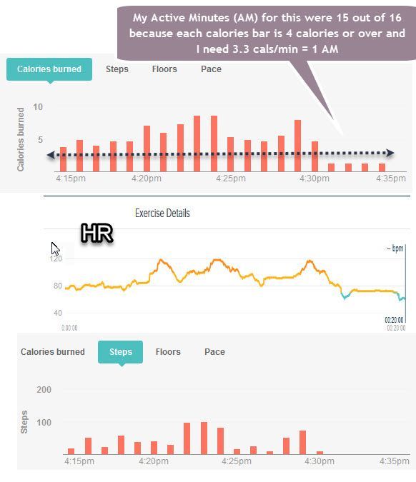

@Elizabeth2222Here is a simple test walking test I performed and it did not SmartTrack.. I received 15 out of 16 active minutes with my settings at 10 minutes.. So now I'm looking for a clue as to why !!!!. Maybe it has a threshold on steps etc.. and not HR/Calories. Obviously it is trying to work out a pattern of movement.
On that same test my One recorded 6.5% more steps and NO active minutes, and that is where the Ionic kicked in with the HR/Calories. I wont accept the spikes but in the 80-90 bpm range I will accept and the calories burnt reflect that.
