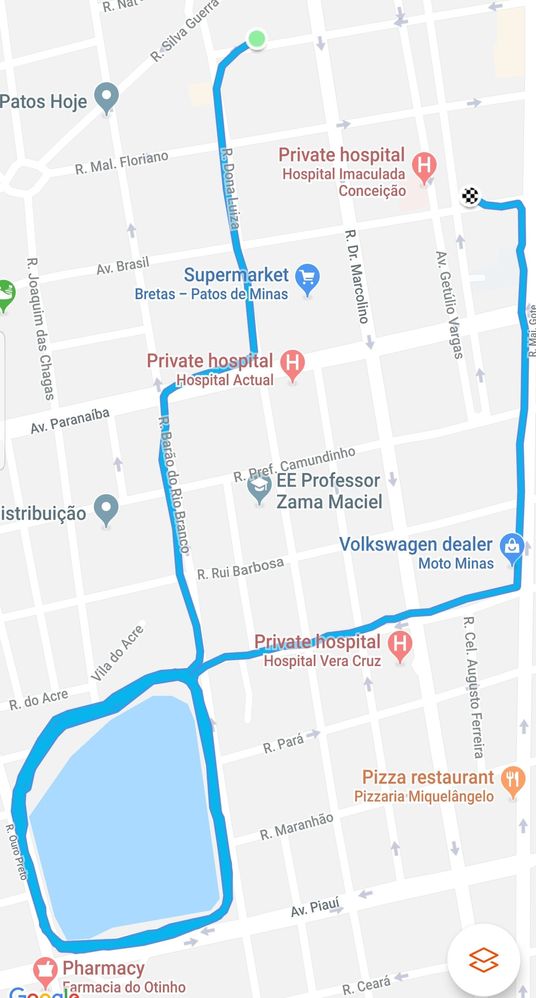

My ionic GPS tracking is ridiculously inaccurate.
As you can see in this picture.
My wife also uses an ionic and her tracking is perfect.
What could I do to solve this.
This way, it is useless.
