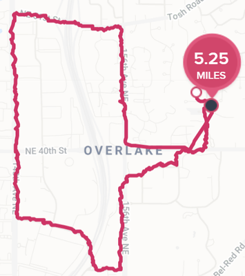

Below are are some examples of what I've been seeing.  As a reference point, the 1st map is from when I used my phone to track my exercise (Walk).  When I do this, the GPS always works flawlessly.  Note the nice, smooth lines with no breaks.

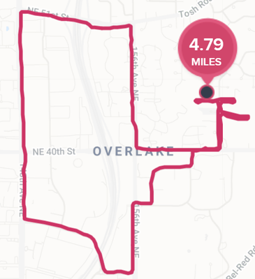

This is an exercise where I used my Ionic to track my walk when the Ionic was actually working "well".  Note the squiggly lines everywhere.  Also note that the path on this walk was nearly identical to the above one, though I left out a couple cul-de-sacs here.  Despite being a slightly shorter walk, it claims I actually walked almost a 1/2 mile longer.  I'm guessing it's because of the squiggles from its detection (rather than the straight lines I was walking, which is shorter).  It also lost GPS connection for a few mins at the end.  This, unfortunately, is really the best case sample for when I use my Ionic to track my exercise.

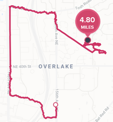

The Ionic didn't fare so well on many of my other walks.  On many of them, the GPS was never able to make a connection so there simply is no map to paste in.  On others, the GPS would cut in/out during the walk,  In this sample, it didn't track the 1st ~15 mins of the walk at all, then lost another ~5-10 mins in the middle (notice the very straight line on the left/top from 40th going north), and then it lost another 10-15 mins toward the end (though it did catch the last few mins).
