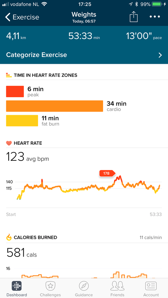

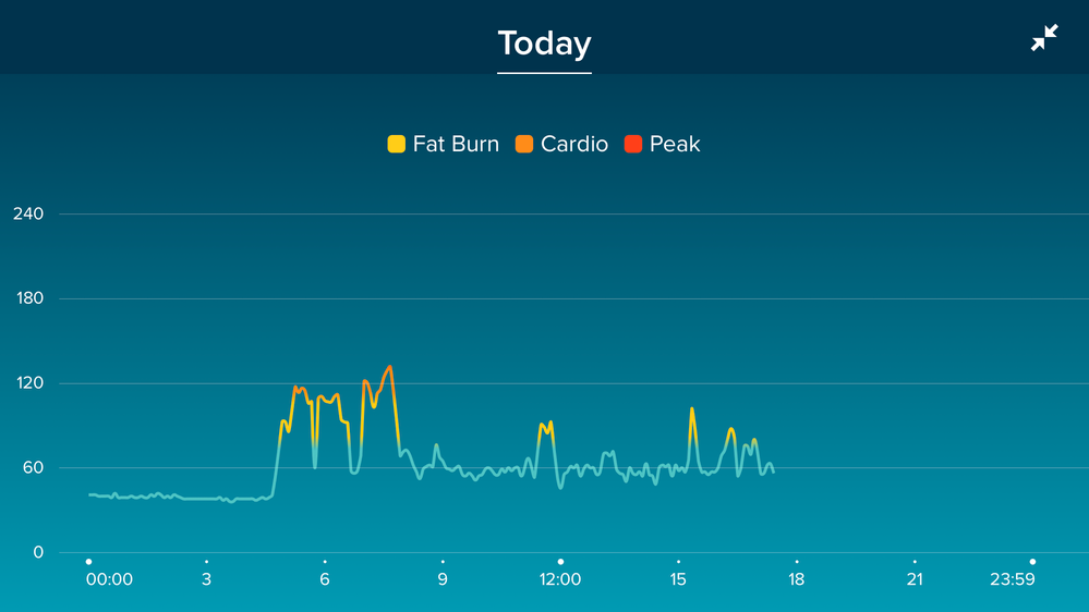

Picture 1 shows my activity from the moment I got up.. around 5 am.. walking for about 90 minutes.. HR high (not correct) but not so high as it sometimes gets. Then from 7 am to 8 am a workout including running. HR lets say around 120 average..
Now have a look at the second picture.. That is the IONIC workout.. You would think the same data, the same graph..but the average hr is higher and there is a peak in there of around 176. Mind you. I ran during the first 15 minutes of the workout and the other part was strength. So everything is still in a development fase I would say..

@wedzir wrote:Now have a look at the second picture.. That is the IONIC workout.. You would think the same data, the same graph..but the average hr is higher and there is a peak in there of around 176.
You would think, but that's not the case. The daily heart rate graph is a five-minute average, while the activity graph is one-minute intervals. Because of this the daily graph gets the peaks and valleys smoothed out somewhat. All my heart and activity graphs exhibit this.
