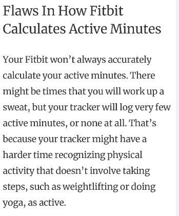

I have done spinning with a heart rate over 100 for 30 minutes and only show 7 minutes of Active Minutes. I track it on my Ionic Spinning exercise with the start & finish. The Ionic shows my resting hesrt rate at 69-70 so with a heart rate over 100 showing I am in the Fat Burning Zone shouldn't I have Active Minutes! I contacted FitBit live chat, he couldn't figure it out & said he would email me but I haven't heard back it's been 2 days.

@Lmrphy08 Our collective input into this topic will help others. Your earlier posts definitely show the relationship between HR and the Ionic detecting little physical activity at the end.. and your walking and spinning definitely proved that. I used 12 minutes for my test last night to confirm the 10 minute continuous and your have achieved that with your Spinning, have the HR elevated and then "cool down" walk..
A few weeks ago when I did some heavy gardening the auto tracking came up with Aerobics, Sport and Outdoor Bike. When I thought through that, I was doing overhead pruning, kneeling and weeding, sweeping, raking and putting the greens into our recycle bin.. 2 hours of non stop. So one could image Tennis, Field Hockey etc so when you take that into account you can see how the Accelerometer with effort can be confused. I have set all of my Auto Tracking to the minimum of 10 minutes..
I did some research on Fitbits active minutes and finally after going though many that only discussed 10 minutes and 3 METs I found these para's in two research papers. This would suggest the Accelerometer. Many of us with early Fitbits found that was occurring. One of the Fitbitters found they were getting more calories burn going down long flights of steps than going up them and a few of us put that down to impact.
