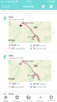

My Ionic seems to be very erratic at the moment.
Distance accuracy is varying wildly. Can anyone explain this to me please. With accuracy this poor the watch seems fairly worthless.
