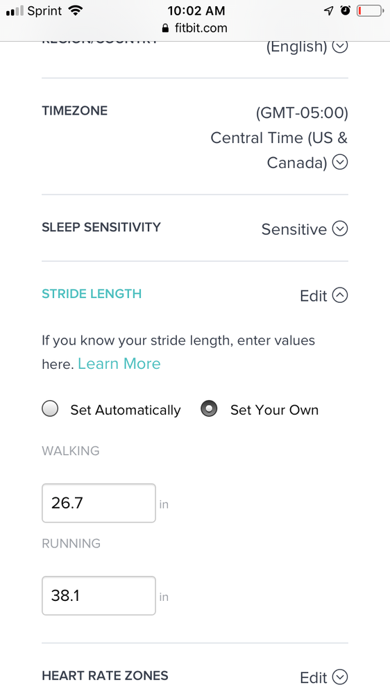

So my stride length is set to 26.7”
Based on that my distance for today should be 4.25 miles, but Fitbit is saying 3.83 miles.
I know that’s not a huge difference, but it’s been bugging me. I am not even sure when the problem started exactly (I want to say it’s been since I upgraded to the Ionic).
**edit: It did start about the time I upgraded from Blaze to the Ionic. I also checked GPS tracked walks and the distance on those aligns with my stride length setting. So as weird as it sounds the GPS tracked walks match my stride length, but the total distance for the day is still off a bit. ** Any ideas?

I am aware of that.
my stride length is set to:
26.7” walking
38.1” running
