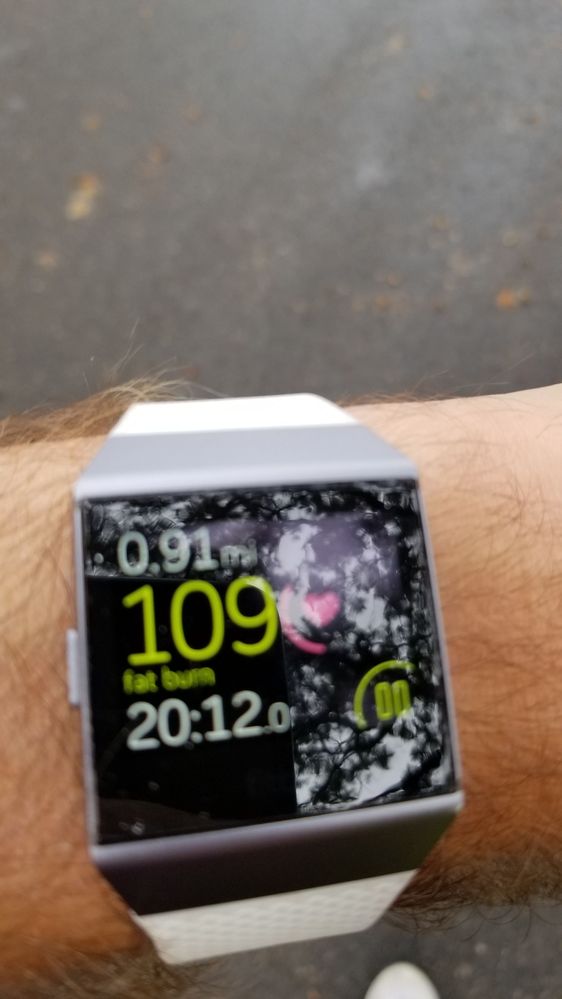

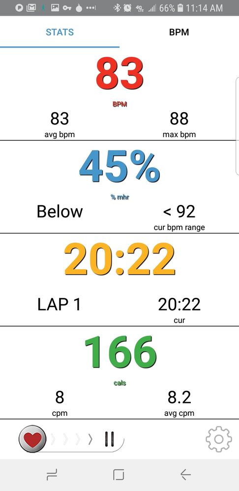

Correct except yours is much more better organized lol. Yes its a basic walk since I was noticing just walking around, my hr was showing very high numbers. So i took these snaps and screens.
Its not in order but if you look at the duration times that are closest are the comparable heart rates at the time.
I agree also that my ionic will show lower heart rates when running than strap almost up to 10 bpms.

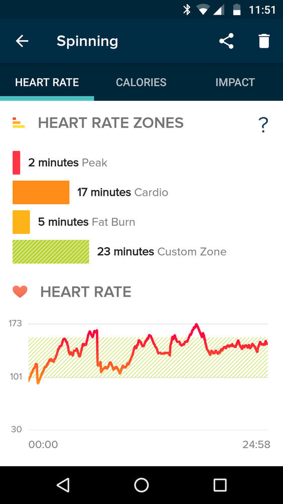

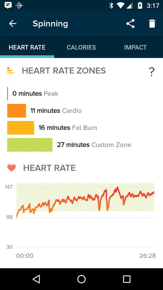

My HR readings have been wildly inaccurate the last few days when I'm on my bike. I have it set for Spinning to get a more accurate reading. This morning I restarted the Ionic 3 times because the first time I was too low, the second time it spiked like crazy and the third time I just let it go. I monitored my pulse manually every few minutes and I was around 130-135 for most of the workout. The graph below from this mornings session says otherwiseScreenshot_20181123-151717.png
Keep in mind that I never stopped pedaling when I restarted so I was already cycling for about 10 minutes. I have no idea where the spikes and dips came in because I was not doing intervals today. Yesterday's results were worse from doing intervals.
I think this is an example of how inconsistent the Ionic can be. I got the opposite yesterday. I did a 10 minute treadmill running session, as a warm up to a gym session. I'd normally expect my HR to rise to about 120 in an short exercise like this. Instead, within about 45 seconds, it had leaped up to 150. For the next few minutes, it carried on rising, eventually peaking at almost 180. My professionally measured HR max is 160. Apart from 180 being impossible for me to reach, I'd only been running for a few minutes and was hardly out of breath. Over the remainder of the 10 minutes, the Ionic reading slowly fell back down to between 120 and 130. I suspect that, when I'd finished, the reading was about right. Results like this are completely useless. My patience with the Ionic is wearing very thin in less than two months of use.

Another day of HR bouncing every which way. This was a steady paced ride. No change in resistance or RPMsHELP!HELP!
