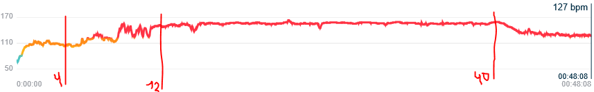

On Sunday I did a session in Sports Training mode (random resistance at selected baseline) on my elliptical, with my Ionic loosened 1 notch but a little higher up my arm.
That didn't work out too well. It only measured 125-130bpm, while I certainly hit higher bpms during more the intense periods.
So yesterday I reverted to my previous MO: don't change the tightness, just keep it like day-to-day wearing, but slide it as high as possible up the arm until it's tight. And block the watch from sliding back down by putting a sweat band in front of it.
I got better results last time, but this time again it was reasonable.
Cardio workout targetting 158bpmCardio workout targetting 158bpm
0-4min: warmup, elliptical at lowest resistance
4-40min: cardio workout, resistance varies to keep HR at selected bpm (I choose 158bpm this time)
40-48min: cool down, elliptical will gradually reduce resistance back to lowest level
It could have been better the first few mins of the workout... but at minute 12 the oHR seems to get its act together all by itself until the end.
So I'll just stick to this method I guess. It's not perfect (my Surge did a better job at this, without having to find out tricks), but ok.
