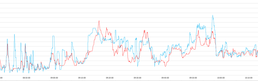

However, from the moment I started wearing it I felt like the heart rate wasn't quite right. When checking my wrist, the Ionic was about 8 beats per minute ahead of what I counted myself. To be sure I wore both my old charge 2 (on my right wrist) and the Ionic (on my left wrist) for a day.
Here's a screenshot from me waking up that morning, Ionic in blue, Charge 2 in red. Every horizontal line is 5 beats per minute.
Now, what's going on here? How can these two trackers have such different results? I've been wearing them both according to the through fitbit recommended instructions.

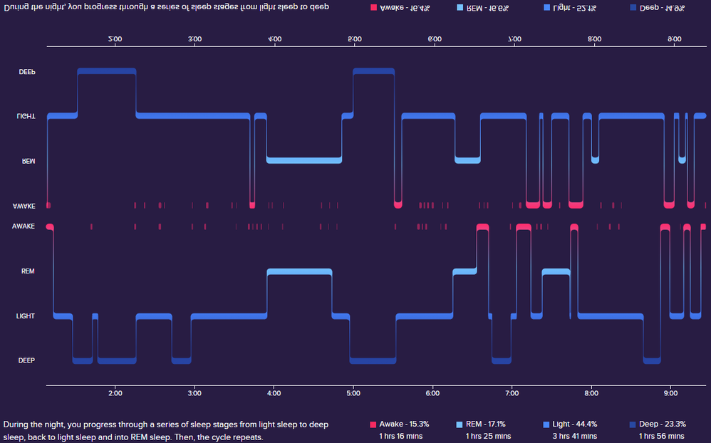

Sleep also isn't entirely similar (note that they aren't the same length so are a bit skewed at the end):
So, well, who's lying here? And how can I be sure that I've got some thrustworthy data to work with? I really looked forward going to the Ionic from the Charge 2 but now I'm doubting both.

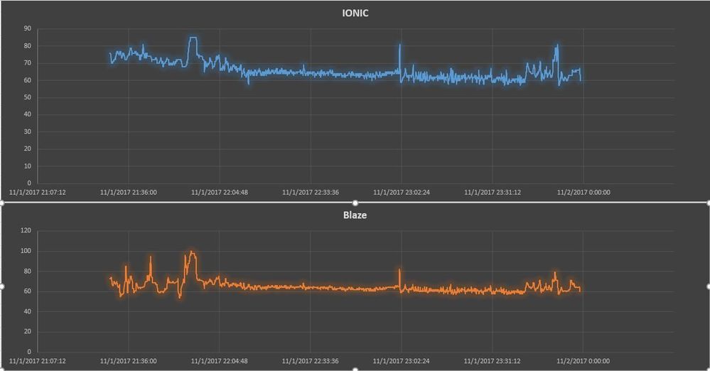

Last night I wore old Blaze on right hand (marked as dominant in the profile) after registering it as a new user and ionic on left hand. I extracted data from 2130 to midnight of 11/1/2017 and produced the comparison below. From the raw values it does appear that ionic has a tendency to show a slightly higher heart rate, even at rest (lying down in bed).  fitbit_ionic_blaze.JPG
@Venkats thanks. Do you plan to swap wrists and repeat the experiment tonight?
Did you mean wear both the watches on same wrist or swap the watches, wear blaze on left while having ionic on right.
I will do what you want but the point is Blaze (on right) matches with my BP monitor while ionic (on left as I would wear the watch normally) seems off by 3 beats ofcourse that was not a continuous measurement.
Once can arguably say 3 beats is too low and statistically insignificant but when seeing what happens during workout, it seems rather significant.
Swap wrists. Never use two optical HRMs on the same wrist and expect to get valid results. We all hope to see the same 3 beat difference when Blaze/Ionic are on opposite wrists. I vaguely recall someone doing a similar test earlier this year and not getting the same difference. So just curious, if you don't mind. Thanks in advance.
