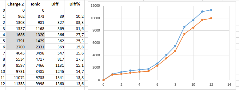

So I made a test of step count with my old Chage2 and new Ionic. I had them on one hand side by side and it seems that Ionic undercounted the steps. Mainly it is apparent in the small step batches like roaming around house or office. The 100 and 1000 (marked by grey) step test outside was quite correct for both of them. The difference showed on my chart is around 13% but it would be considerably more on days with not much share of longer outside walking. I have to say I am not really happy with this. I have checked the forum and it seems that there is quite a lot of people having similar issues. As the Ionic is out for some time, it seems there is no working solution.

This is probably an obvious question, but have you made sure they are both set to the correct wrist placement in settings (dominant vs non dominant)?

Sure. Everything is set to same. I had made some of these comparisons before as I had One, Charge HR and Charge 2 before.
It seems that the difference occurs as the Ionic does not count steps if you make just a few of them. Like if you stand from tv and go for five to ten steps they are not counted.
Well, the only outcome I could take is that these let's say "daily service steps" do not really have an impact on your health. So if you want to get your goal you have to really move. But I'm not sure if I am not just lying in my pocket to justify 315€ spent 😕

I know what you are talking about, I can best describe it as a buffer of some sort (ignoring those initial 5-10 steps as erroneous unless you fill the and exceed the buffer). I think this is programed into the software to try to avoid false steps. Maybe the algorithm differs between the two trackers for some reason.
Have you tried setting the Ionic to the non dominant setting to see how it compares to the Charge2 set on dominant? I can only imagine the non dominant vs dominant setting changes the threshold of this software buffer, making the device more or less sensitive to those initial steps. I really don't know why both devices would differ though, only fitbit can answer that.

I agree with the general assessment here that the Ionic does not always count what I call "putterint" steps very well.
However, I think this is a GOOD thing. It is very unlikely that, for example, getting up to change the channel on the tele (oops -- who even does that now),go to the loo, or opening the door to let the dog out adds very much to one's fitness level... So I am quite happy that when I have basically been a couch potato, I don't get the idea that I have "walked".

I agree that the Ionic counts less steps than my other trackers (flex 2 and Alta HR). I always regarded my flex 2 as a good step counter and the Alta HR as slightly less accurate. On step tests of 100 steps the Ionic is consistantly 1 to 3 steps under and the flex 2 1 to 3 steps over. Where i find the Ionic shines is the huge difference in false steps when out on my bike. With the flex 2 I got thousands ( 3 to 4 thousand over a 20 km ride). With the ionic I get 2 to 3 hundred. So yes, I think it does slightly undercount (mine anyway) but it is actually (a lot) more accurate when you look at the whole picture.

I don't think it's a buffer to ignore 'non-steps' because you don't get them back when you exceed said buffer, they're just never counted. Also, I've had a charge 2 , blaze and others and their buffer counter has been working fine and never mess things up like this.
So, seems like a software error or bug? Don't see why the ionic would handle the buffer differently from all their other trackers, just doesn't make any sense to program it differently from the others ...

Yes good point about exceeding the buffer and then getting the buffered steps back. That would be expected behaviour. It could very well be a bug in the software, I don't think it's a hardware issue. I shouldn't imagine it's too hard to fix, but knowing Fitbit, who knows....

Hi, @jlynnjaxon, as @N8teGee mentioned, the wrist worn trackers won't count steps until a certain number is detected (I think it is about 8 - 10 minimum). If you carry on walking, it will back count (and that is why if you watch your Ionic while you are walking it will seem to do nothing, and then suddenly have a jump in steps.)
If you are preparing food in the kitchen, walk a few steps to the fridge, stop and butter some bread, walk a few more steps, stop and slice a tomato, walk, stop and look through your cupboard, etc etc, you may never trigger enough steps to get it counting continuously.
This is to keep it from counting too many false "hand" steps (it wants to see you WALKING in order to count). You may find this unacceptable, but it is, in fact, working exacty as it is designed to. My impression is that most people want to use the step counting facility as a way of improving their fitness and getting more active. If it counted every puttering step you might get a very exaggerated idea of your level of activity...
To check whether your device is working properly Fitbit advises you to go outside and without carrying anything and with your arms hanging naturally by your side, note the step count on your device, then walk normally, taking 100 steps. Count each step as you walk, then check to see how many your Fitbit has counted. Fitbit claims 95% accuracy, so you should see 95 to 105 steps for your actual 100.
