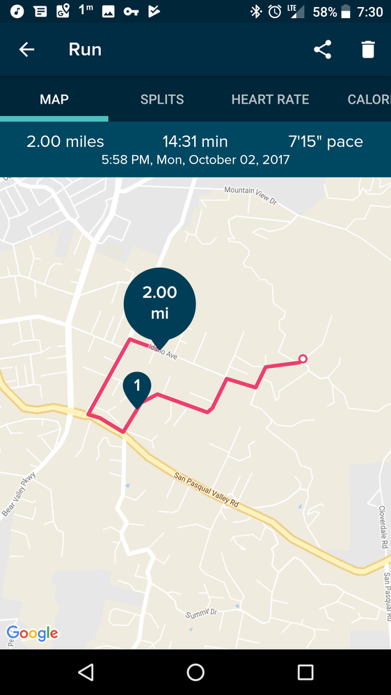

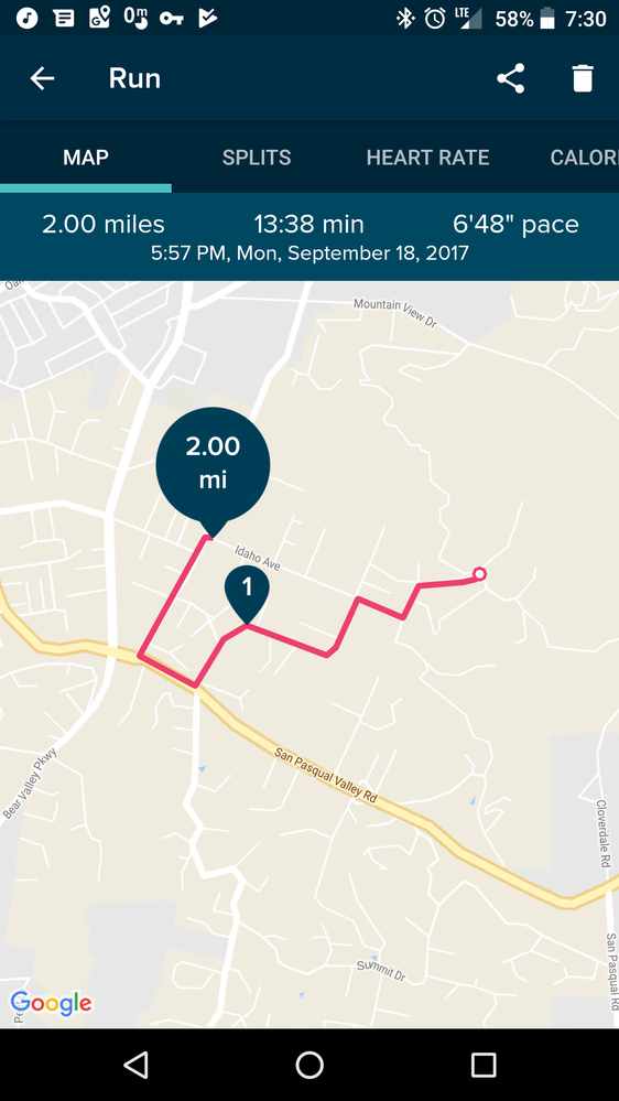

So I'm a long time Fitbit user. Have been using the blaze and the surge for a while now. I've stuck with using the Surge for GPS because my blaze always had problems with connected GPS and without using GPS. I just got my Ionic and went running and thought my time was slower until I got back to my phone and sync'd and looked at the maps. I'm guessing the ionic is off. Attached are copies of runs so you can see the difference. Early in the run with the ionic... It showed my pace as 14 mins.

I don't get it.
So the map on the top is with Ionic and the one at the bottom is with the Surge? It this the case the distance measured is exactly the same (2.00 miles) on both pictures and the tracks are practically identically perfect. Only that in the first picture you took longer than on the second hence you were slower.
Something wrong?

Yes the bottom is the surge and the top is the Ionic. If you look at where the 1 and 2 mile marks are... The Ionic took further to hit 1 and 2 miles. Still the same path but a longer distance.

Yes, sorry, I didn't notice that. You might want to export the txc and compare them with a service like www.gpsvisualizer.com to see where the differences are.
And then expecially to measure the real distance in the map.

In the first image, the total time is 14:31, whereas in the second it's 13:38. The different mile markers notwithstanding, it doesn't seem like the GPS is the issue; the recorded times are actually different. Were these both taken on the same run? If so, [Edit: just noticed the dates. I thought maybe they were the same since the start times are so close together, but I guess you're just really consistent about when you run. :)]
Is it possible that you started/stopped the watches at different times during your run?

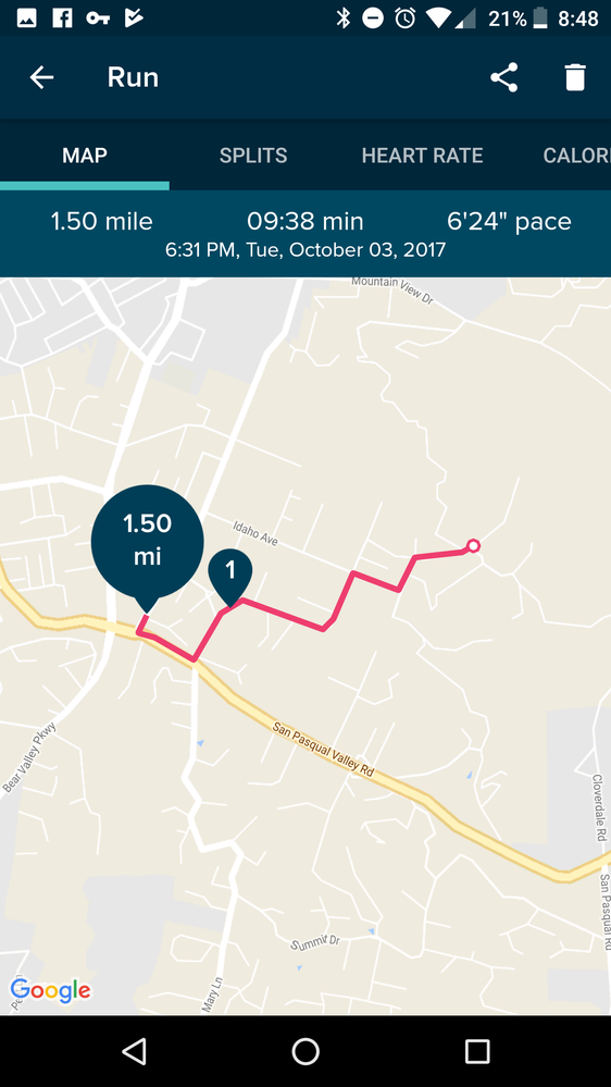

So I went running again and then went walking in a controlled distance that I know is a mile. The running time and distance seemed right and different this time from Monday's run. The controlled
