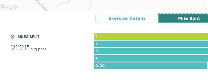

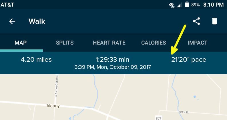

@SunsetRunner, are you saying that the Average Pace does not display on the Ionic screen, or that it is not available at all? It is displayed on both the Fitbit.com dashboard and the app after the exercise is synced to the app.
