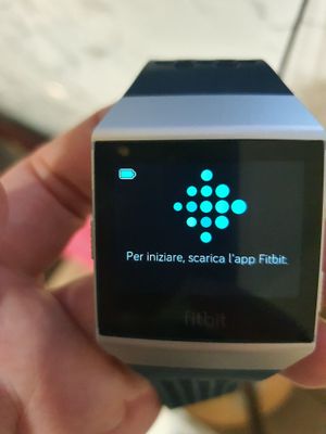

i manage refresh the ionic but appear another problem. it say i need to download fit bit app.
what is happening now???
02-14-2020 05:40
02-14-2020 05:40
Is it tell end you to setup with the Fitbit app @theo_indo? or is it telling your to unlock with the Fitbit app?
