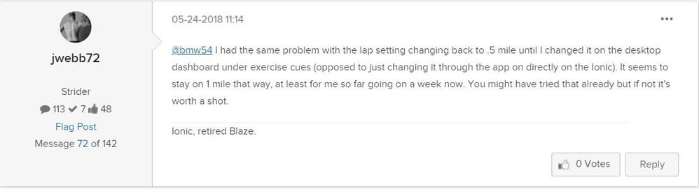

@LongDistanceRun
I searched back in my posting history and found the actual advice I had followed that succeeded (finally) in changing my cue from .5 to 1.0
Here's a jpg I snapped of it (I wasn't sure how to quote from one post to another thread):
Give it a try. If it works thank @jwebb72

@LongDistanceRun here is a direct link to the original workaround:
https://community.fitbit.com/t5/Ionic/Custom-stats-not-saving/m-p/2732743/highlight/true#M56042
Change the setting using a web browser.
Hallelujah! Resetting from the DESKTOP NOT THE DEVICE - did the trick! Thanks so much!
