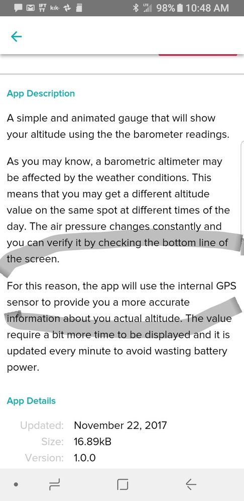

I'm having a similar problem. My readout is expressed in feet rather than meters. Pressure is expressed in kPa.
I concur that there may be errors in the elevation indicated as this appears be based on barometric pressure but it does state that it uses GPS to provide a more accurate reading.
The dial indication on the left side indicates an elevation of ~50 ft i.e. +50 ft. The upper portion of the scale is blank a lacks the tick marks as well as the "50" and "100" ft markings.
Best Answer12-27-2017 12:05
12-27-2017 12:05
Another thing to bear in mind is that a lot of these apps aren’t from Fitbit but rather independent developers. As such it is difficult to assess the level of testing of features and not really Fitbit’s fault if they don’t necessarily work as expected.

One of the reasons I bought the Ionic was to monitor my altitude after diving. I got the Altitude app which was giving totally inaccurate readings, like -50m when above sea level. I noticed other people also complained about this. Is there an app that provides accurate altitude readings that I can rely on?
Best Answer12-28-2018 09:04
12-28-2018 09:04
“Is there an app that provides accurate altitude readings that I can rely on?”
I have the Altimeter app on the Ionic for general interest only. Have not found any Fitbit App that provides accurate altitude readings that I would rely on. The Ionic has a sensor but the developer uses the internal GPS. Would recommend you try it out and see if it is accurate enough for your purposes.

Rich it is by Marco Castiello. Search Altimeter and it will pop up. He talks specifically about barometric vs GPS and his reasoning. I am just reporting this. Personally I would not ever trust GPS or the Ionic for any accurate altitude reading. Just too inaccurate. But for general interest comparisons -> the values are interesting for checking variances.
