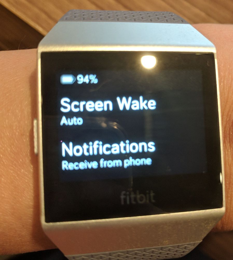

The results are in.
Yes you can pause the workout for as long as the battery would allowPaused before going to bed last night
Battery at 94%, with GPS enabled and Always-on display disabled

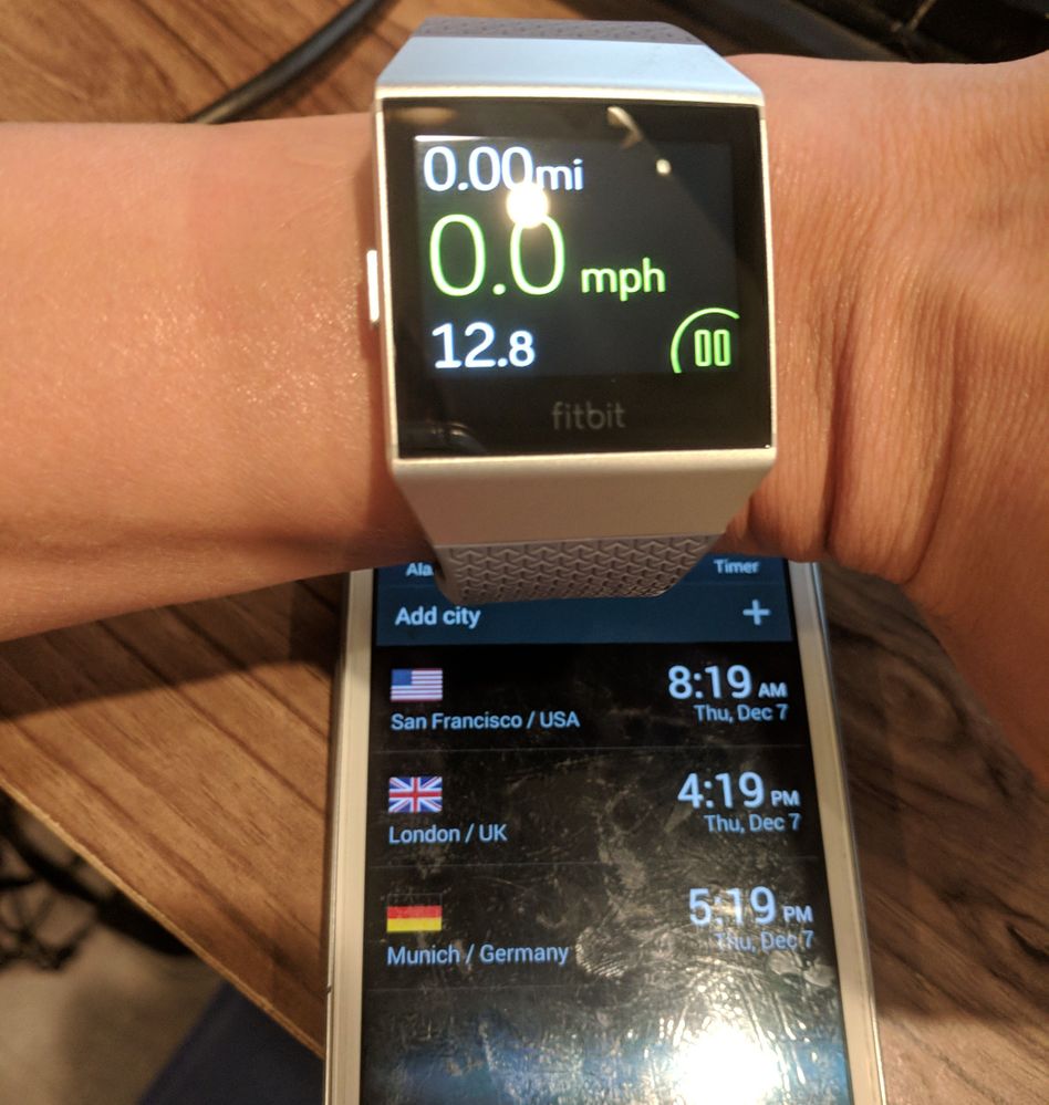

And...... 8 hours later

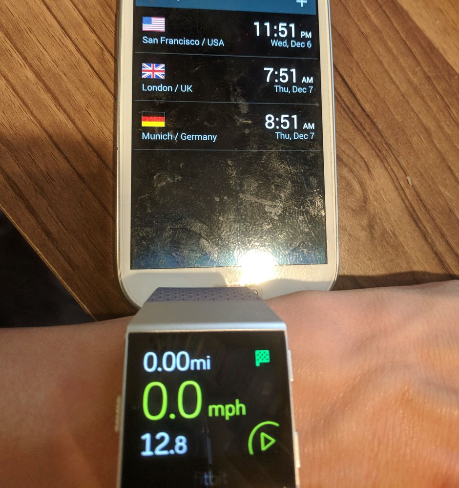

Still able to resume ...
Battery now at 19% though..
Judging by the battery drain, it would appear @dermbrian is right about GPS continue running even when tracking is paused. I don't suppose there is currently any workaround?
