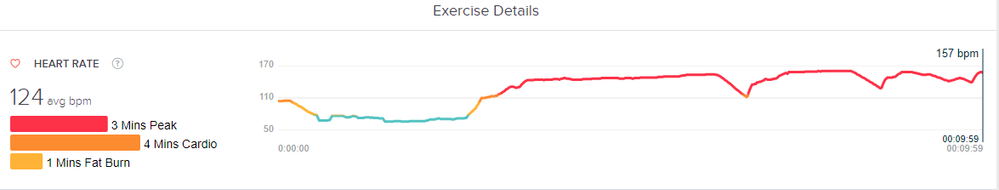

I linked my Peloton bike to fitbit, and did a 10 minute ride to try it out. I use the Peloton heart rate / strap. After completing the short workout, I see the ride show up in my dashboard but it looks like it's pulling the heart rate from the watch and not the Peloton.
Is this by design, a limitation of Peloton data, or error? I looked at the ionic a few times and particularly in the beginning, the heart rate was way off -- more like my resting HR. (This was after another cardio workout so my starting rate was already high.)

Best Answer@bhwolf Fitbit will only record HR data from a Fitbit tracker. And Fitbit does not allow importing HR or GPS. So forget about "open ecosystem" for HR/GPS because its a one-way street.
To answer your question, its a Fitbit limitation by design. And secondly its been widely reported that Ionic struggles in first 5 minutes, although usually its too high.
First thing to do is play with placement on wrist as per the Fitbit help articles on heart rate. That said, I've seen various issues with optical wrist HRM and cycling/spinning over the years, starting with Surge (worst), Blaze (better, but hit or miss), and original Apple Watch (better than Blaze, but also hit or miss). Optical HRM on the wrist is generally ok for stationary bikes, but in my experience sometimes it will be tracking fine and then misses the beat for 3 or 4 minutes. That makes it hit or miss for me, and since I use HR-to-Power metrics for cycling fitness trending, that means I still wearing chest strap. Unlike some people, I've never had a problem wearing chest strap while cycling/spinning so its no big deal. And if I did have issues with chest strap, the next best HRM is Scosche Rhythm+ which is worn above/below elbow and is more immune to accuracy issues due to location.

Best Answer@bhwolf yeah, its unfortunate you can't disable Ionic HRM and have Peloton send HR data. Maybe someday Fitbit will allow importing HR/GPS, like every other fitness platform I've used, but I'm not counting on it.
The silver lining -should be- that Peloton sends calorie data along with workout duration (does it?). My rides from Garmin bike computer are sync'd to Endomondo, which syncs to Fitbit and creates a manual cycling working - from that I get calories/miles/duration on my Fitbit dashboard. I have a power meter on my road bike, and Wahoo trainer, which is usually more accurate for estimating calorie burn (vs heart rate based estimation).
If it continues, and bothers you, then I suggest taking off Ionic or simply turning off HRM during the workout. Definitely worth continuing playing around with position/tightness of Ionic to see if you can get better results. And retesting after every Ionic firmware update.
Best AnswerWhen the ionic is tracking appropriately, it's really close to the Pelo heart monitor, so that's good. And yep, it does send over calorie data and it all matches (well, other than the HR).
Actually, I originally looked because I was wondering how the fitbit would reconcile my HR/activity during the ride (I don't start an exercise activity on the watch) with the data it would receive later from Peloton. I wanted to be sure it wasn't duping my effort.
I'll leave it on for now but "trust" the Pelo HR strap over the Ionic, and hopefully the accuracy will improve over time...
