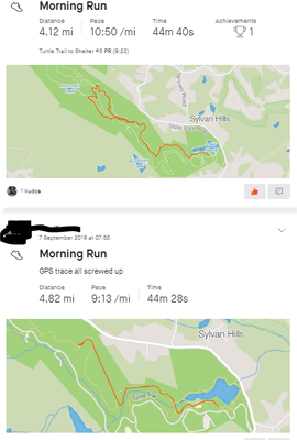

Ionic is the only Fitibt with built in GPS (ie no need to take your phone too), and frankly it can be buggy as hell. Most of the time its OK, but it cant be relied on 100% (see example clip of two identical runs captured from Strava!). You can do the stuff you want, but half the time the apps dont run as intended, and compared to other options there are not than many apps available in the first place. Plus you get to play update roulette everytime there is a firmware update, wondering if your device will still work afterwards.
