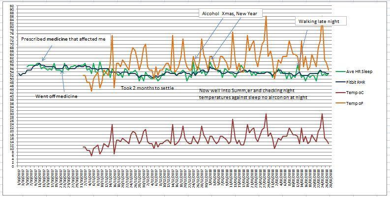

Since I had a reaction to some medicine I have kept the graphs and looked at night time sleeping temperatures in my suburb in Melbourne.. It took me nearly 2 months to eliminate a medicine from my system. I had a spike in blood pressure, my doctor was away on leave,and I thought a 2nd opinion would do no harm. This doctor put me on a calcium blocker.. Symptoms headaches, tingling down both arms and when I went for a walk my calf muscles locked up within 70 steps.. I was taken off that after 10 days and now everything is OK.. Cardiologist all clear.. The image below reflects sleep ave HR and RHR using the Ionic
Also when I had a hip replacement in 2015, no cartilage in the Left Hip. My RHR went up to 74 and took about 3 months to settle down. I also had to warn the nursing staff that my HR gets down to 43-44 when asleep.. even with the high RHR.. that set the alarms going because the night nurse wasn't warned.. Today my RHR is 52 and Cardio Score is 43-46.
I have found the RHR accurate and a precursor to colds etc..
