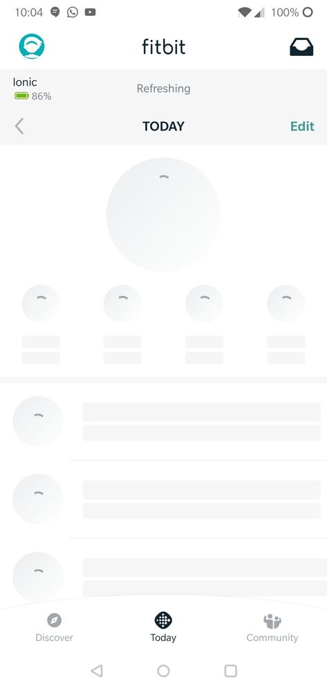

I got my new ionic recently I started to use this from past one day it was fine till night when I started using again later it was like app is not working fine and I was a synchronisation issue I have tried to solve but don't know where have I missed so If you know something do let me know

Sorry @Satyakunda but app not working fine does not help us much.
What phone or computer is the app on?
I assume the tracker works so what is it that is not showing correctly in the app?

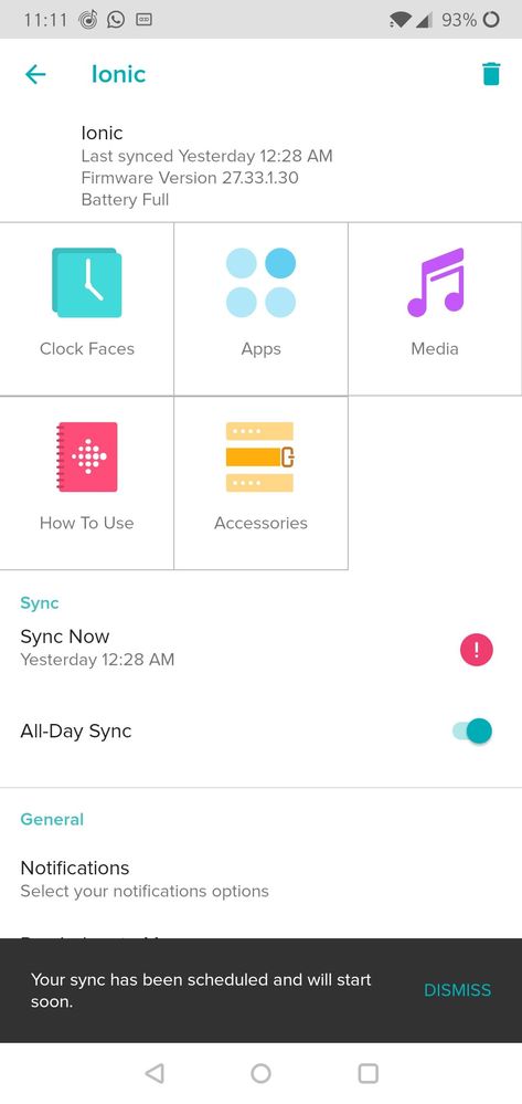

And another thing is when I am trying to sync it was like your sync has been scheduled and will start soon and app is also not working fine even after connecting to WiFi it was not showing any steps and any other activities and do find the below attachment

The usual things to try when you get syncing issues are:
I also notice that your phone is not on fitbit's list of supported devices at www.fitbit.com/devices However, if it worked when you first set it up then it should be possible to get it working again.
