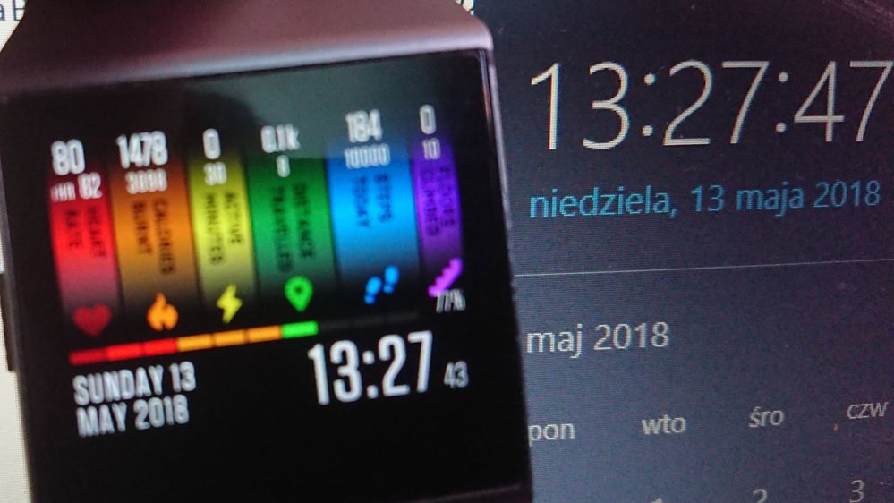

It already has the latest software. Uploaded. Unfortunately, the problem of missing seconds (time lag) continues to occur. In the photo attachment. After synchronization it is 2-3 seconds. This time increases when the watch is not synchronized. With the new software, I restored the watch's factory settings and reinstalled the FITBIT application.

@Misma Thanks for your reply, updating Ionic, trying those steps to sort this out, and for sharing that screen shot!
Thanks for this feedback, I will be forwarding this information to our team. It is very important for us, so thank you again!
