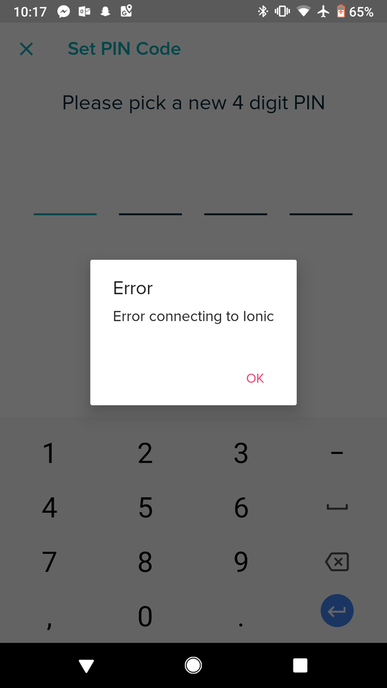

Hey, I am having some problems. My device is locked and as I try to unlock and change the pin it says it cannot connect to my iconic. Even though it syncs all the time. Hope you can help thanks.
Welcome to the Community @Ryan_mccarthy. Thanks for trying to change the pin on your Ionic.
Please try the following steps:
Thanks for the tips that you've shared @SueL999!
Hope this helps! Keep me posted.
As I previously said it is not that part that I am having issues with. It is coming up with an error when trying to connect to my device even though it syncs all the time. I enter a new pin and the error message comes up.
Thanks for the screenshot that you've attached @Ryan_mccarthy. In this case, I would like you to log out from your app, force quit it and then log back in. Before, setting up another PIN, you may want to restart your Ionic as well.
Thank you very much. The logging out and In fixed the problem!
