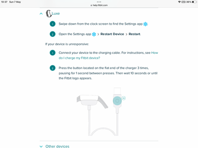

Hi, @Janet300 , have you tried a restart? As your Luxe is unresponsive you will have to restart using the alternative method. Here’s a screenshot of the instructions:
You can find full information about restarting your device here . You may need to try the restart a couple of times as a single restart doesn’t always work.
If the restart procedure doesn’t work I would suggest getting in touch with Fitbit Customer Support on Contact.Fitbit.com .
