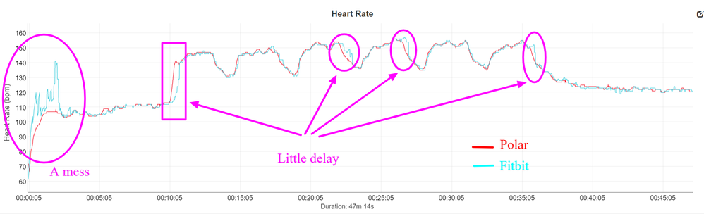

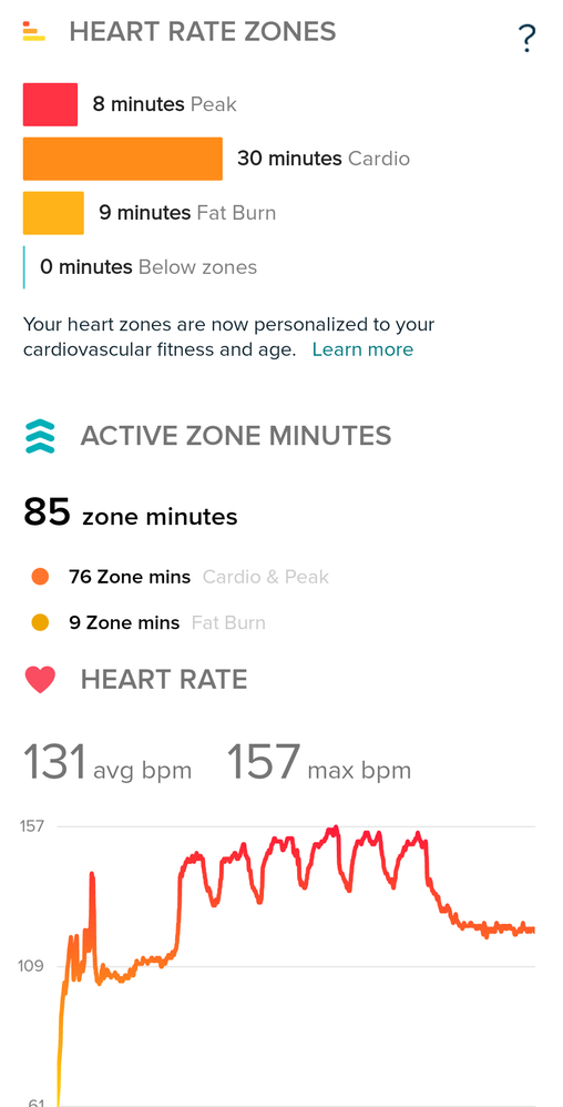

Yesterday I run a session with 6 fast intervals, a session that is very demanding for the heart that needs to increase the beats rapidly.
Here is the result
As you can see apart the first 3 minutes where Lux had big problems to acquire a stable signal then the graph is actually very good with only few instants of delay during the transitions.
Below you can find the original screenshots from the respective apps.

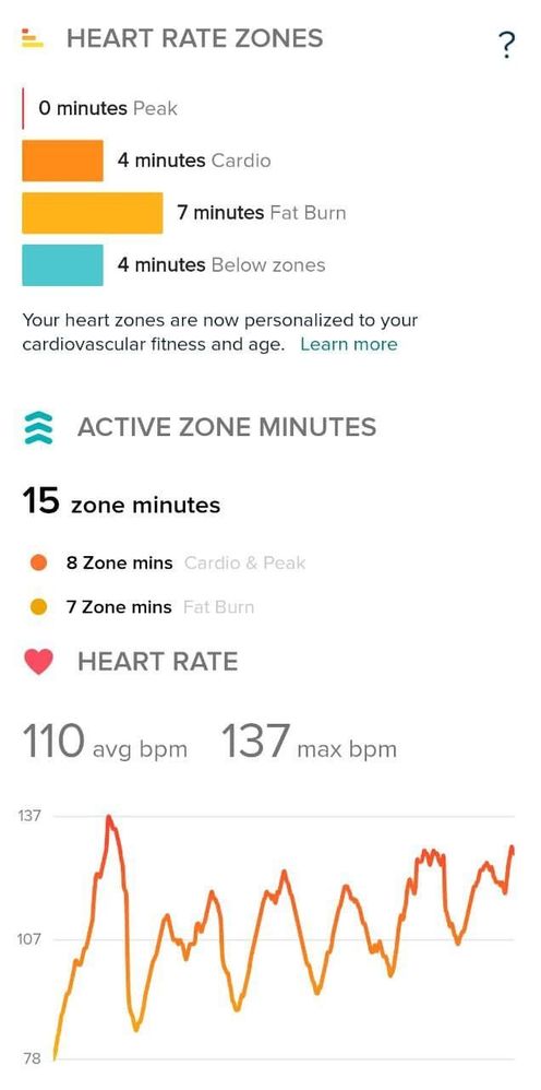

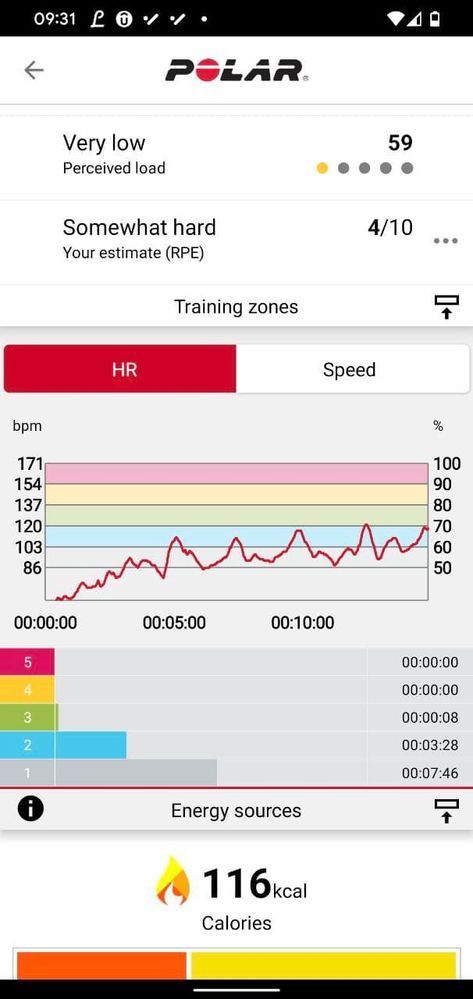

I also tracked a workout (it was a session part of 12weeks program by Adidas Training) and while I can't compare the HR similarly (Fitbit export tool for non GPS tracked activities has a bug and return an empty TCX, problem highlighted to Fitbit since many years) it seems that they are not to different (note: for this specific case I used Polar with H10 chest monitor)
