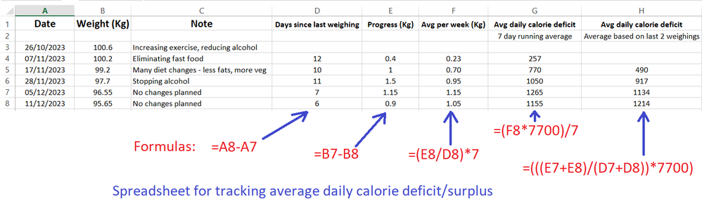

To determine how accurate your tracker is at calculating calorie burn you can use this method:
1:            Track and log your food intake in detail for at least two weeks.
2:            Track your weight weekly during this time period.
3:            Estimate your average daily calorie surplus/deficit for this time period.
I use a spreadsheet to do this (screenshot attached) though the math is quite simple.

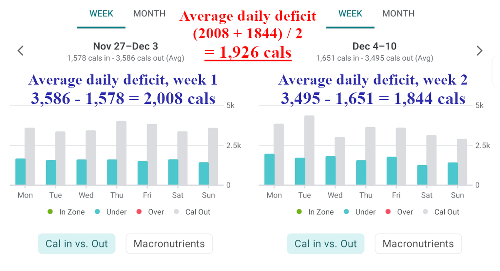

4:            Compare this figure to the weekly ‘Cal in vs. Out’ graphs in the Fitbit app.
Screenshot attached showing my own numbers.
Testing tips:  Do not change your diet or exercise routine significantly during the test period.  If you are currently making major changes, wait a while for your body to adjust before trying to verify your daily calorie surplus/deficit.  Weigh yourself at the same time of day and (ideally) the same day of the week.  First thing in the morning after using the bathroom is good.  This helps to minimize big variations due to water weight – a pint of water weighs around half a kilo, so your breakfast and morning coffee can make a significant difference.  Stored body water can also make a big difference, though if your water intake has been relatively steady for a few weeks and you don’t make big changes during the test period this shouldn’t be too great an issue if you weigh yourself first thing in the morning (after you pee).
I have a Charge 6, am currently fat, unfit, and am losing weight.  In my case the app is showing me a calorie burn that is inflated by over 700 calories per day on average.  That’s a whole dinner for me.  I’d like to confirm if this is a Charge 6 problem or a general Fitbit problem, and whether this is a common problem for people who bought a Fitbit to help them lose weight.
