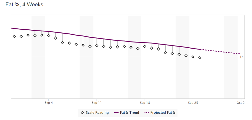

That has always puzzled me (seen a lot of that on the Aria help forum), as in the 4.5 years I’ve had my Aria, it has always been very consistent with BF%. In fact, these user comments were what prompted me to get a second scale (Withings), which turned out to behave exactly like the Aria.
My Aria has been exceptionally consistent during the past four weeks, with every single BF% value within a 0.5% fluctuation range (max: 14.5, min: 14.0):
 I also had a non-weight scale mini-victory this morning, as I saw 13.9% on the scale display: first time ever in 4.5 years I see a value below 14% Smiley Happy.
