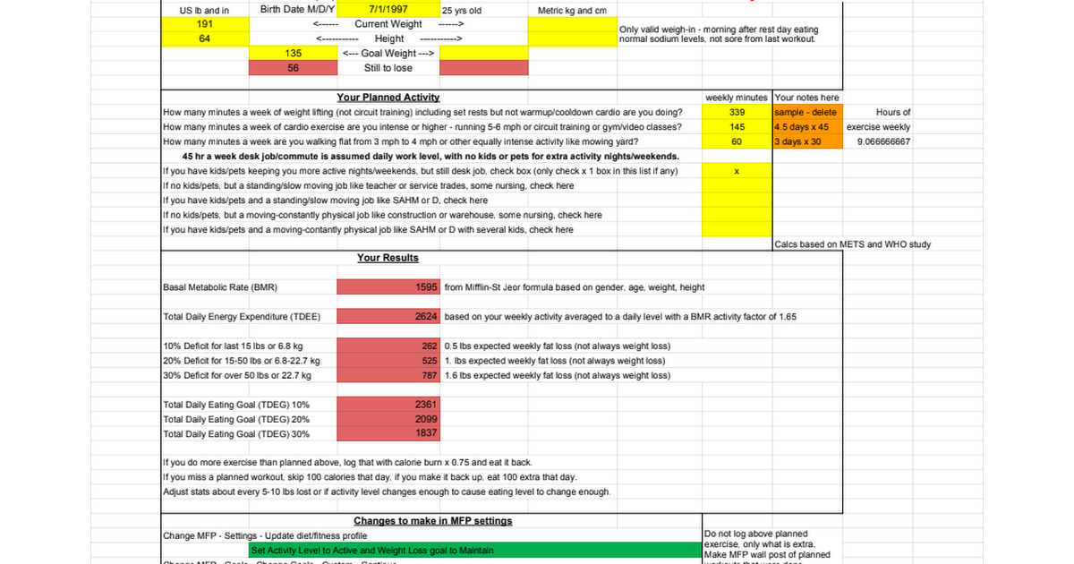

Just TDEE Please spreadsheet - better than rough 5 level TDEE charts from 1919 study.
https://docs.google.com/spreadsheets/d/1G7FgNzPq3v5WMjDtH0n93LXSMRY_hjmzNTMJb3aZSxM/edit?usp=sharing
Which makes me wonder if the Fitbit setting for being on a weight loss goal stuck correctly. But the answer to couple questions above will settle that.
Help the next searcher of answers, mark a reply as Solved if it was, or a thumbs up if it was a good idea too.
To use this you must use the webpage (not browser) menu item File - Make a copy, or File - Download as .... Excel or other spreadsheet option. Google has app that handles it too, once you copy to your personal My Drive space.
