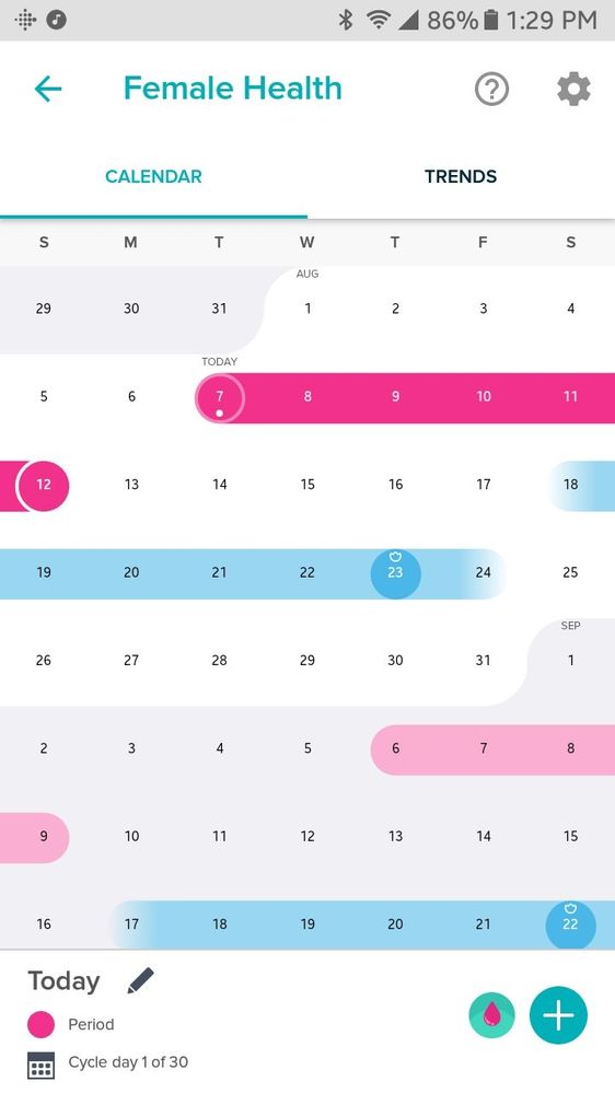

Agree with all Android users. On my Android, I can't move the bar from Saturday to Sunday. I wish there was a way to manually type in a date (or choose from a calendar) for either start or end date. It's hard to use this feature if you can't adjust the dates to the actual specific date.. for example: the app predicted my period started last Friday, the 3rd, but it actually started this Monday, the 6th. I can't move the bar past Saturday because of the screen/line break. And YES I'm trying to drag it slowly.. it. does. not. matter.
And yes my app is up to date.

I've just encountered this issue - OH MY GOD SO FRUSTRATING!!! Took me about 20 minutes, playing around with every which way I could think of, and suggested in 'Help', to figure out that the only way to edit a current period that falls over a weekend is to:
* Go into Advanced settings
* Change the day the week starts
* Go back to Female Health and edit the days by dragging (also, this is NOT easy to do anyway - please come up with something simpler, Fitbit, like a "Choose the date" scrolly thing, or drop-down, or something...)
* Save the edited period
* Go back into Advanced settings and change the day the week starts back again
Fitbit, I love you, but please hear myself and others reporting this: if the predicted period starts towards or at the end of one week, and lasts over into the following week; and the actual day it starts is on the following week (example: predicted to start Friday, week ends Saturday, period actually starts Sunday), the app DOES NOT ALLOW you to drag the bar from one week to the next - you have to do what I just described above. If we're going to do the "accuracy" thing, let's make it possible to actually be accurate easily, please and thank you 🙂
Also, I'm using iOS, and yes my app is up-to-date, so this would appear to be an across-the-board issue (just noticed some folks are stating they're Android users, and the comments to update the app etc).
Hi @Luroc,
After a lot of playing around, I discovered this fix:
Your issue is the reverse of mine, but the principle is the same, ie the bar cannot be dragged between two different weeks, so try that and see if it works ![]()

Hi @Luroc, @mmeyers and @WhiteQueen1982 Thanks for sharing your feedback about the Female Health App.
Thanks a million for the time you've taken to find an option to successfully edit your period. The information that our good friend @WhiteQueen1982 shared called my attention, since it worked for her. I know that this is not the ideal since it should be working with these steps, but I'd like to confirm with you if this is working in all scenarios. Rest assure that we're taking your comments very seriously and sharing this information to our team.
I'll be waiting for your response.
Best Answer08-18-2018 08:05
08-18-2018 08:05
Yes, this worked for me! I imagine that depending on where the start and end dates are in the week, this fix won't solve all problems but it worked for me. Phew!
