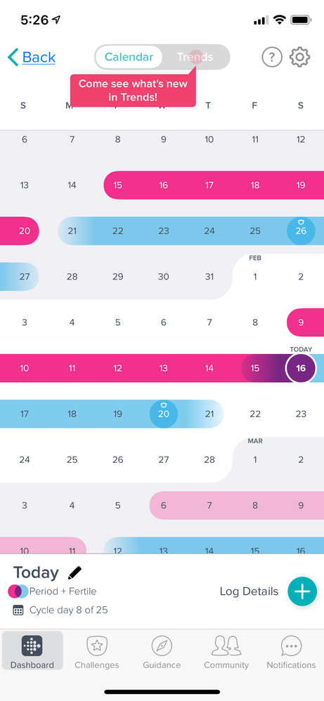

The app predicted my period to start last Saturday (9th) and it started on Wednesday (13th)-later than predicted. I cannot get the date to move. I’ve tried going into Fitbit.com’s website in the computer and it’s still not helping me edit it.
This DOES need to be updated if we want it to work properly, and be a useful gesture, because now the app is telling me I’m fertile when I ha e only been menstruating for a few days, and now next month’s period will be incorrect too.
Best Answer02-18-2019 07:20 - edited 02-18-2019 07:21
Hi there @Manderlyh, it's nice to see you around here! Thanks for the screenshot provided my friend.
If a period doesn’t meet the following requirements, you may receive an error and be unable to log the period:
Note that If you attempt to log a period in the future or a period with less than a one-day gap between periods, the pencil icon is unavailable. If you don’t see the pencil icon, make sure the period you’re attempting to log or edit meets all of the requirements.
My sister had a similar issue, her period was 2 days late this month. For her the current day and all future dates all had a grey pencil and could not be edited. Well, she tapped on yesterday's date which had a black pencil so she was able to edit the period like that.
So, tap on a day that has already passed, where there is a black pencil, then edit your period.
Hope this helps!

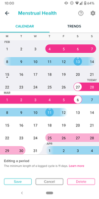

I'm also having trouble editing my period in this app. It tells me that the minimum length of a logged cycle is 11 days. It certainly looks like I meet that requirement, so I don't know why that message comes up.
My period started early by 2 days. My periods usually last 4 to 5 days, so I wanted to change the predicted end date from the 6th to the 3rd. I've tried closing and restarting the app, but still, I cannot move the date when my current period will end.
Am I doing something wrong, or is this just how the software is?
