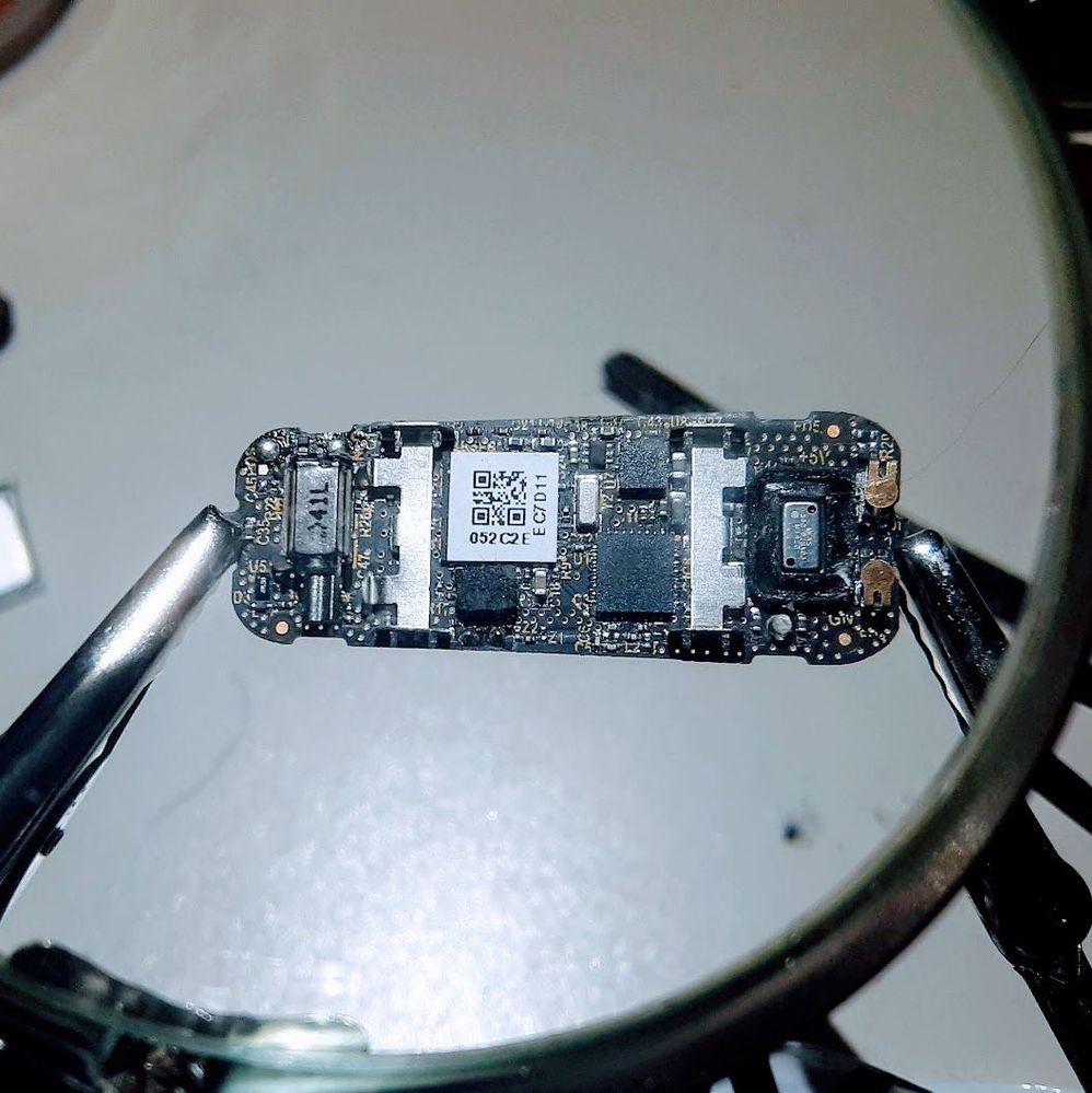

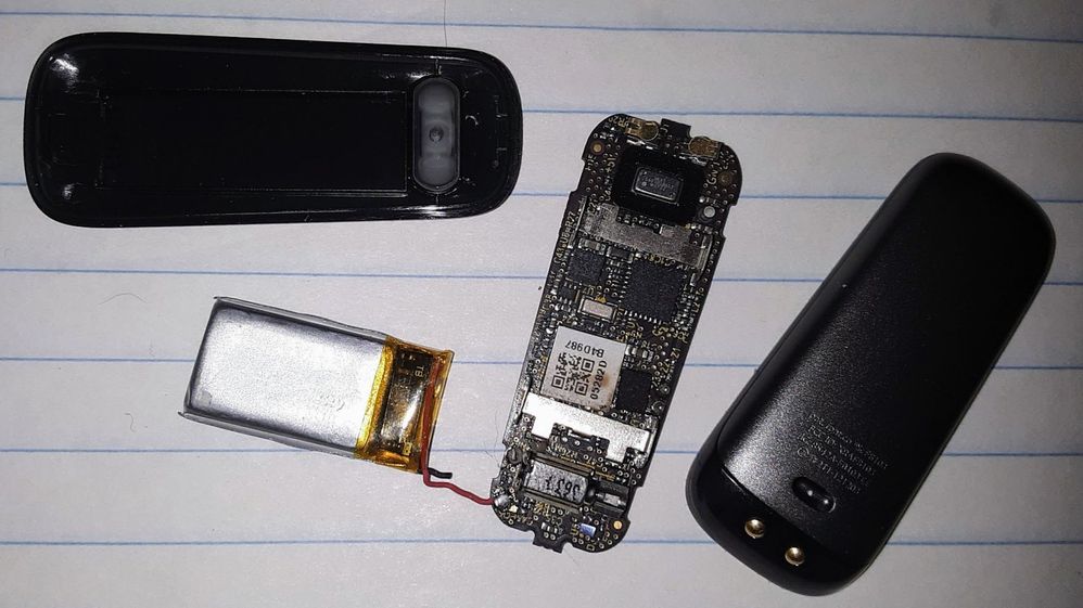

@jj60152 I respect your perspective and recognize others have expressed similarly, and although not part of Fitbit's support or technical staff I assure you the engineers haven't written a firmware code that kills devices, it's just not done. I've spent my professional career working with the largest tech companies on the planet, this isn't something that happens. Errors and oversights can happen (usually fixed with another update), but the 6.46 has proven stable for over 3 years. It improves battery life with the addition of being able to turn off real-time data tracking.
The reason it appears that the firmware fried your device is simply its the release date, these trackers are destined to die within 3-4 years, it's just the nature of the lithium polymer batteries (with a few outliers that run past their destined death date).
I've personally replaced batteries in over a dozen Fitbit Ones for myself and others and all are updated successfully to 6.46 without any issues. Check out this one in the pictures, I'd purchased this "brand new in the box" dead Fitbit One that appears never had the negative battery wire successfully attached (or even enough solder to hold it into place). I'd added a drop of solder and charged her up and BAM running great and upgraded her firmware to 6.46 and she's now running perfectly with the battery lasting for over a week. Yes, my Fitbit One identifies as female 🙂 LOL
I'm happy to provide tips on repairing these for anyone interested and have posted several threads in this forum with step-by-step pictures and instructions for replacing the battery as like yourself and most everyone here, I'm a big fan of this little tracker. Have a beautiful day!

@Greeneyesmlt if the Fitbit is dead off the charger, attempting to sync from a computer isn't going to help resolve things, it's simply a dead battery and needs to be replaced. One burgundy one right here lasts 2 weeks on a single charge, tracks steps perfectly but can't connect to the app. If it's working off the charger, then you can attempt disabling Bluetooth on the phone and having Fitbit re-enable it or attempting from a PC, but, if it's dead, software can't resurrect it, only a battery can.
I've literally got well over 2 dozen Fitbit Ones in front of me. Some simply can't sync, there's something wrong with Bluetooth and they're technically nonfunctional, the remaining majority simply have dead batteries, either at the factory level (cables weren't ever connected properly when assembled; someone at Foxconn must've not had their coffee that day) or from natural degradation as these batteries weren't ever designed to last for more than 2-3 years. There are outliers too, I've got some perfectly functional Fitbit Ones that are 7+ years old and still run well (though only a few days of battery compared to over a week when new).
