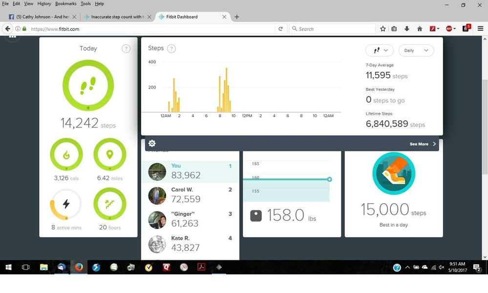

I just returned to Missouri from a trip to Nevada and have a similar problem. I have reset my One several times and it's still showing a ridiculous amount of steps. The odd thing is, the graph on the web page appears to be accurate. Attached is a screen shot. Also, my Zip (which I use as a backup when my One is charging) is showing the same number of steps, which makes sense since they're synced to my laptop and my phone. I should add that both tracked the time zone changes just fine and I had no problem in Nevada.

I think I understand at least part of the problem I'm having - it appears that it didn't reset at midnight. If I take the steps I have so far today and subtract yesterday's steps, it's about right. Same for the floors, but not for the active minutes. I was able to chat with a Fitbit rep and while there's no real solution to fixing the number of steps on my Dashboard, at least he told me that this sometimes happens with time zone changes and at midnight tonight it should reset properly. We'll see.
