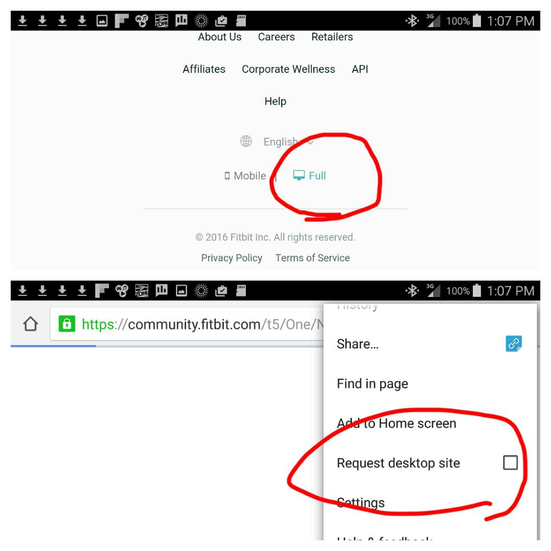

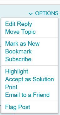

Now if you want to edit your post,  i do this several times a day. In the right top corner of the post is an "option menu". Clock on it and you will see an entry called "edit".
If you happen to be using a mobile device, you'll need to put the web page in desktop mode. Either press the Browsers menu, then request desktop mode, or scroll to the bottom of this page and press "full".

Finally, you can edit your posts, you need to click on the options next to the post like this:
Just select "Edit" and you should be able to amend your post.

First, there are no options for me when posting from mobile Chrome as I am now, so no editing unless I'm on a laptop. And because I work 12hrs/day on a laptop, I don't spend any outside of work time on it. When I get on a laptop I'll take a look at the page code to see what scripting they likely are using instead of a good old html text link at the bottom to edit. For things like forums, simple code is ALWAYS better.

Regarding editing your posts:  I just tried editing from my phone (Microsoft Lumia 950) and it works.  Granted you have to be in the full version of the site.  If you scroll all the way down to the bottom of the page, you'll see this:
Click on Full (as indicated above) and you'll have the option to edit your post.

While it is not needed, since i spent the time to edit and put together these screen shots, using strickly the phone. I'm  posting thos.

Thanks for the tip on the Full option.  I also could have requested Desktop from within Chrome, but generally don't think of going that route unless I am doing something pretty significant such as financial or other similar important form filling activities.

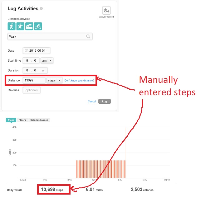

Having your wife enter her steps manually:  This is already available.  If you go to your activities page, and go to the very bottom (click on the walking icon) and enter your steps as a walking activity, like this:
Yes, they'll reflect on your dashboard.  This is screenshots from my inactive account.  Fitbit does track manually entered activity differently, for instance they do not count towards badges nor Fitbit challenges.

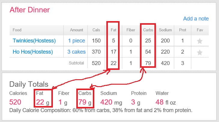

Fitbit not tracking carbs or fat:  While I don't log my food through Fitbit, I entered two items to see if they tracked carbs and fat in the Food Log:
And they seem to register just the way I would expect.  May I trouble you to elaborate on how you expect it to tabulate your carbs and fat?  Or better yet, just enter the suggestion to the feature request section.
