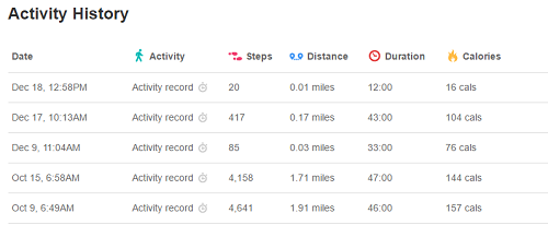

Best AnswerIt does not show up as exercise. That's why I'm confused, I tried that and it didn't work, and I cant figure out why.
I already tried going through the dashboard, and renaming the activity periods. They show up on the dashboard, but not in the app. It's not really useful to me since I use the app, not the dashboard. And the exercise count in the app remains at 0 days per week exercised, even after I use the timer, and go into the dashboard, and rename the activity.

the bold is confusing me The activity records are your recorded Exercises. Can you please take a screen shot of your Exercise tab like i did above

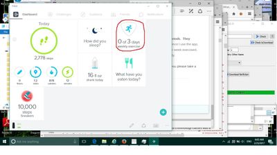

Best AnswerFollowing your instructions, going through the edit button on the bottom of the app's main screen, allows me to select or deselect the exercise tile.
I already had the tile open (on previous picture, circled in red) in the app, it just stays at zero days exercised and shows no exercises even if I use the timer for an activity period, and go into the online dashboard to rename them. The exercise tile in the app does not record the timed activities as exercise. Manually trying to add an exercise period either doesn't work or artificially messes with my step count, depending on the method used.
