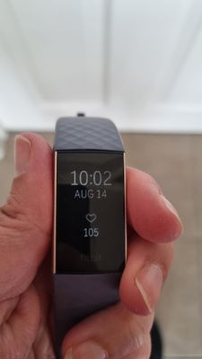

I cleaned the connecting points with a alcohol wipe and it's now charging.  However it still has fading issues on the right side of the face. Hard to capture in the photo as the camera seems to enhance the pixels.  It's not what you see with the naked eye, it's a lot faded and dimmer.20250815_124313.jpg
@NotFitOneBit   Fitbit released the Charge 3 almost seven years ago, making it a rather old device.  Screens and batteries can fail, even in long term storage.  I don't think there is anything you can do to improve the screen.
There is one thing about your picture that caught my eye.  Can you clarify the band color?  The Charge 3 has a rose gold/blue gray combination.  Your band color looks more lavender, a band color that was only available on the Charge 2 (I had one and Fitbit didn't sell replacements in that color).  If it is a Charge 2, then it is an unsupported legacy device.

It's definitely a charge 3.
@NotFitOneBit   Thanks for that photo.  Just being complete.  But like I wrote, I don’t think there is anything you can do to fix that screen.
