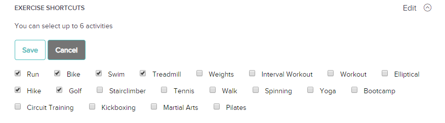

Hello @Glojoy, it's great to see you around in the forums. Sorry for the late reply.
Thank you for your inquiry about the exercise mode and how to change the type of activities that you can choose from. As @Dominique already mentioned, these are called Exercise shortcuts, and you can find them on your Fitbit app by going to the Account icon > Tap your device image > Tap Exercise Shortcuts > Then you'll be able to see the exercises selected and the other ones available for you (like yoga, bike or walk):
Let me know if you have further questions or if you were able to find the option to add them to your device.

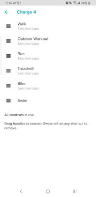

what do I do if I only see 6 exercises once navigating there? I don't get the checkbox screen...

I have the same problem. How do I add more exercises??

Hi @Lindz524, welcome to the Fitbit Community forums, and sorry for the late response.
Thank you for sharing that you've been having trouble with the exercise shortcuts.
Could you please confirm how many shortcuts are you able to see on the Fitbit app? If possible, could you please share a screenshot of this page as well?
In the meantime, if you're seeing less than 7 shortcuts, please try to restart your device following the steps listed here.
Please keep me posted.
