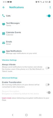

If the assumptions are correct however, the first step I would like to try and correct the issue for you would be to make sure you have re-elected your default notifications correctly. This can be done by opening the Fitbit app. Tapping on your profile picture. Selecting your device from the device list. Selecting Notifications. Once you have done that you should see the screen below:
Please confirm you have selected the correct default applications for each of the headings (Text Messages - Calendar Events - Emails)
Once this is complete you can select the last heading (App Notifications). This will populate a list of all the applications on your phone. Select the apps you wish to receive notifications from and then head back to the main window of the Fitbit app and force a manual sync.
