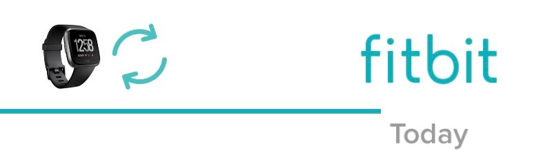

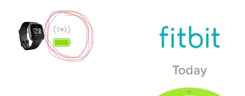

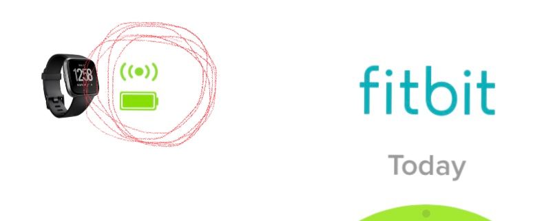

Yes. With the app open, the Bluetooth syncing process does not complete on a first try. The ((*)) icon blinks, goes between gray and green, the sync arrows spin, the progress bar moves  part way across the screen, then it drops out. If I select the Versa and watch the “Sync Now” spot, it goes between “looking...”, “Syncing...” and “Sync Now” rapidly.

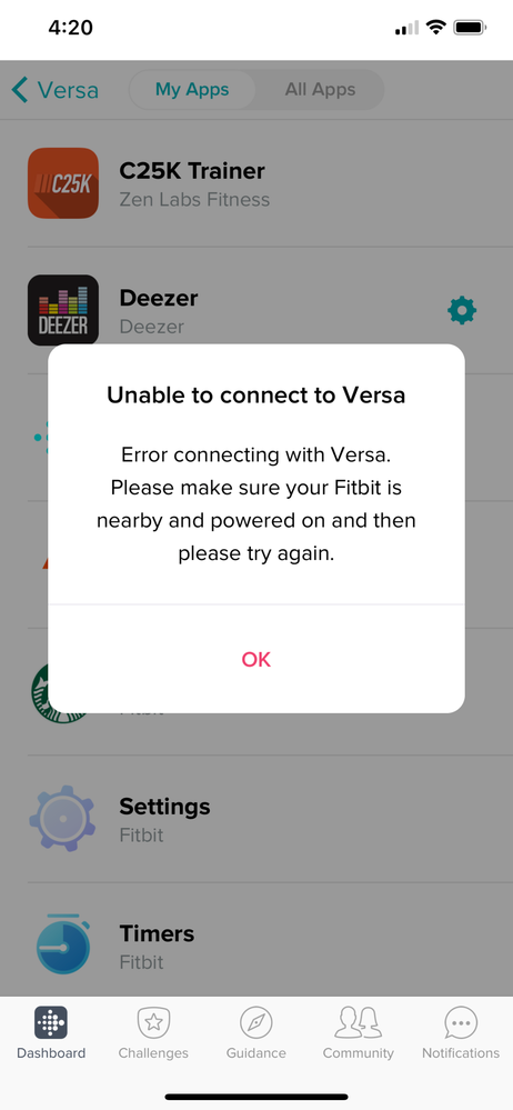

I’m fairly certain it’s Bluetooth (stats from Versa to app). Although changing watch faces and adding apps causes inconsistent “Unable to Connect” messages.

Truth. And I get within a reasonable range if needed.This message comes and goes every couple of seconds.This message comes and goes every couple of seconds.
Shows this for 2 seconds, but doesn’t sync.Shows this for 2 seconds, but doesn’t sync.
Shows this for another 2 seconds...Shows this for another 2 seconds...
Shows this for another 2 seconds...then the cycle starts over.Shows this for another 2 seconds...then the cycle starts over.
