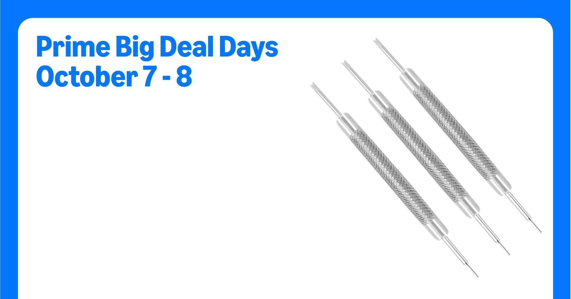

You'll need a pin removal tool like these to get it off the good old fashioned way.
