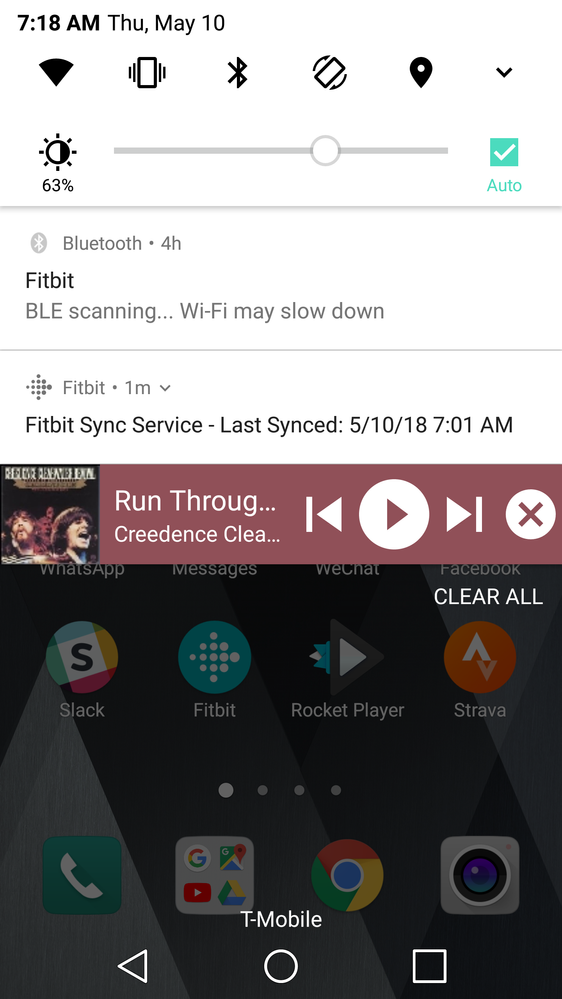

There is definitely something going on between WiFi and Bluetooth. The last couple of times I recorded from Fitbit, it held connection the whole way to work (~9 miles, 40 minutes) then dropped at the same spot in my work driveway. Probably at that point my phone was trying to connect to the known WiFi network.
Also, yesterday morning I saw this notice on my phone:
I'm not sure what that could possibly mean, but maybe it's related. I found this possibly relevant discussion... from 2013!
https://stackoverflow.com/questions/17870189/android-4-3-bluetooth-low-energy-unstable
...and 2015...
https://issuetracker.google.com/issues/37054253
Again, none of this would matter, though, if the Fitbit Android app recorded the GPS data it was sending to the watch, then merged it with the heartrate data at the end of the activity. There's no reason to send the data over the unreliable Bluetooth connection twice.
