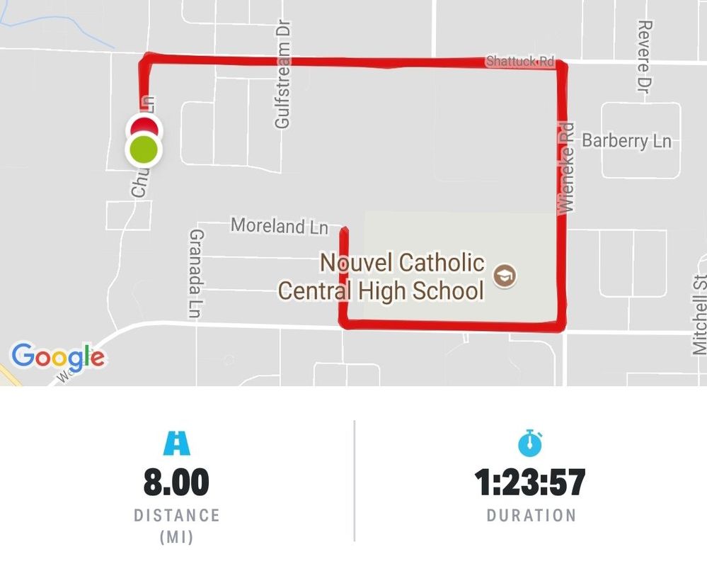

I am coming from a Blaze and while it didn't match Google Fit 100% (normally off by .1 of a mile or so) it was never off by this much. Here are screenshots below showing it:
Completed run in Google Fit:
Complete run with Versa connected GPS:

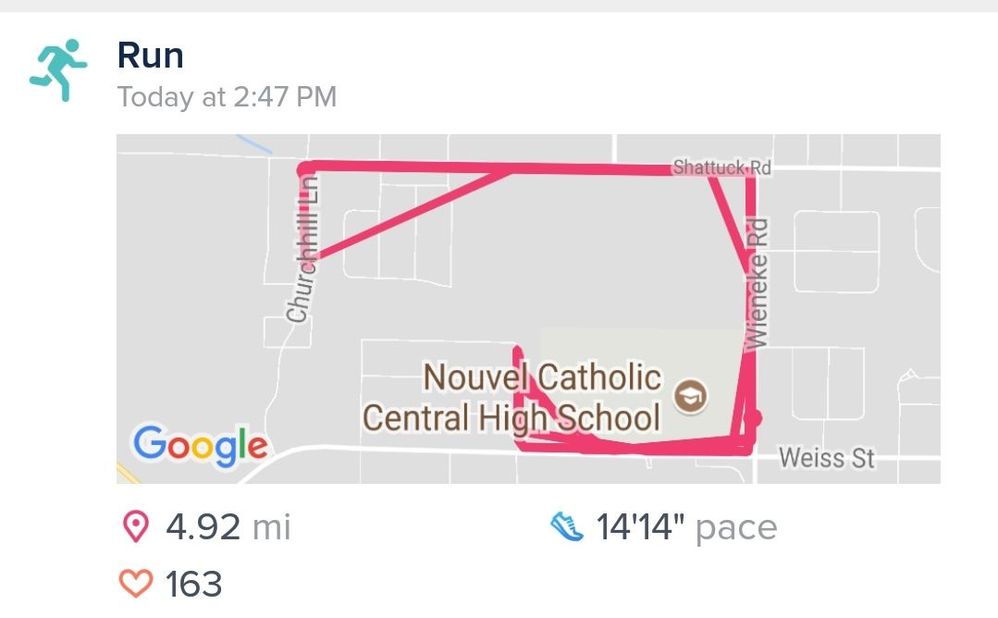

The same run but with the Blaze and connected GPS:
And here today different location at the two mile mark in Google fit:
This is completely unacceptable. If this can't be permanently resolved (and I DO NOT considered constantly rebooting the device/my phone, pairing re-paring, etc a fix) then it will be going back. Add this to it deciding to give me an extra 3k steps while I was sitting on my computer doing nothing last night I am not that happy so far.
EDIT: Just noticed on today's run that the GPS line doesn't start until half way down the run but it was tracking from the start. Where it has the first mile marked isn't even a mile from the point the line starts. Just add it to the list I guess.

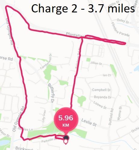

Two runs. Using the same Android phone, under similiar weather conditions.
One with a Charge 2 (that i have been using for quite a while)
And another run with the new Versa.

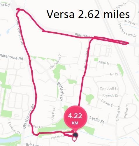

Wildly different numbers, which I think is due to Fitbit Versa constantly dropping bluetooth connection and trying to reconnect (says connecting on watch every now and then).
Please fix this Fitbit. I am very disappointed with the device. It certainly lookslike its been rushed to the market without adequate testing.
Please dont blame my phone and ask me to turn it off and on again, phone is fine. I have also tracked the same run in the past with apps like Endomondo which report the distance as similar to Charge 2
