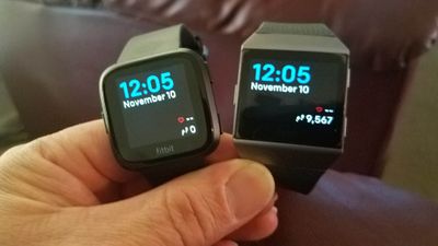

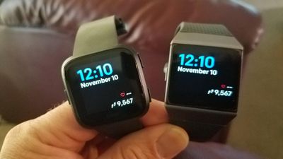

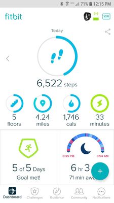

Just tried changing from Ionic to Versa again to provide specific data. I took pictures of the two Fitbits side by side (before and after). Also screen shots (before and after) Here are my findings. I started out with 9,567 steps on my Ionic. I made sure the sync was current (I synced multiple times and checked the status after each sync). I then setup / synced my Versa. It synced with the accurate step count of 9,567. I synced multiple times and the step count remained the same. I walked around to increase my step count and it did on my Versa until I synced again. Then it changed my step count on my Versa and Dashboard to 6,522. Poof just like that 3,045 steps wiped out like they never happened. Thanks in advance for some help.

When are the steps taken when sweeping trackers, and do you check the steps page before adding the other tracker? Your dashboard screenshots are connected and only showing the live data. The Green icon in the top right is telling you the app is acting as a remote display of the tracker.
To get the steps synced to Fitbit one must tap the step tile and check the steps on the next page.

Your dashboard screenshots are connected and only showing the live data. The Green icon in the top right is telling you the app is acting as a remote display of the tracker and why it matches what the connected tracker says. The dashboard is not showing since data.

Yes before a swap or something, they're of no time marks, or noted on what was done, but after the app screen shots the tracker does not agree, and the screen shots do not tell what steps where actually synced to your account. Therefore the screen shots will not give any useful information to work with.
The live data is simply displaying what shows on the tracker, we need to tap though to the next page, out go into Fitbit.com to verify what has synced to the Fitbit account. Only the data that has stunned to Fitbit.com will be transferred to the other tracker when swapping trackers .This would not be a problem if both trackers could be attached at the same time but this is not possible with the versa as and ionic.
We have to submit the current tracker, confirm that the data has synced, then attach the other tracker to the account. This step also removes the old tracker, and synvs whatever the Fitbit account has to the new tracker.
So sync tracker A, then confirm that your Fitbit account matches tracker A, now attach tracker 2.
Failure to make sure that tracker A has synced may cause a change in data when later attaching A back to the account.
