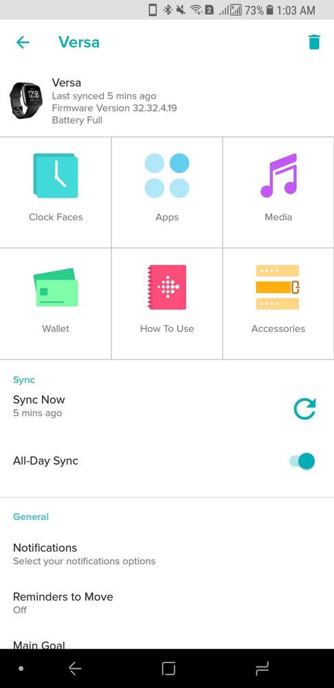

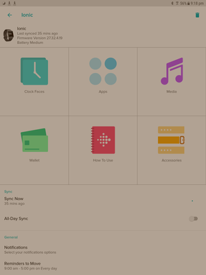

Ok this is for my Ionic, but it shoukd be the same for the Versa. In the app, go to your account (credit card icon) then select Versa. On the page that comes up on my Android select the green wallet tile - see screen shot. Once selected you get the info pages. Tap the red Get Started button at the bottom of these pages and you will be prompted to set a screen lock for your phone. Then you need to set a pin for your Versa, and then you are able to start inputting your card details.

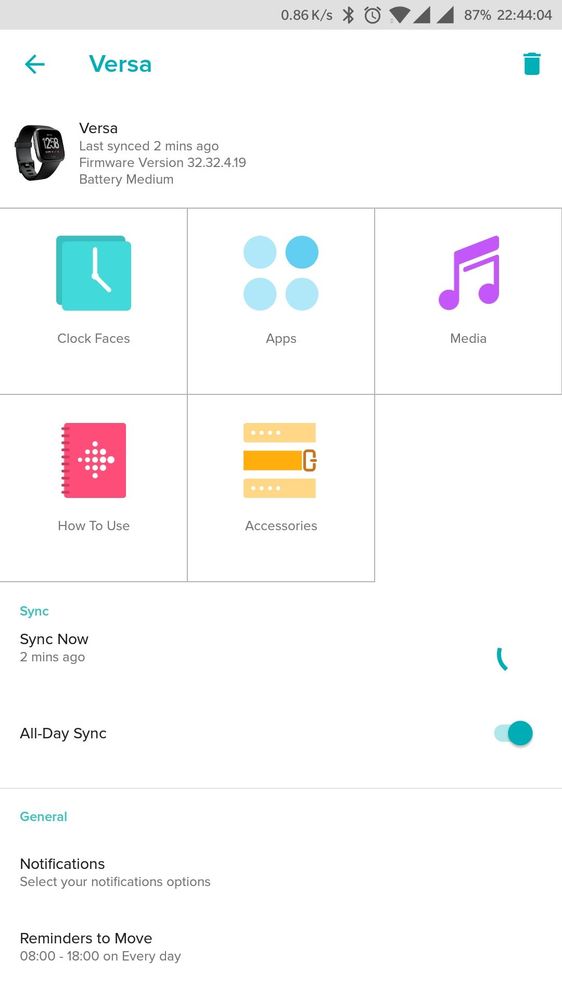

Hey
Thanks for your reply, unfortunately I don't have that tile. See screenshot.

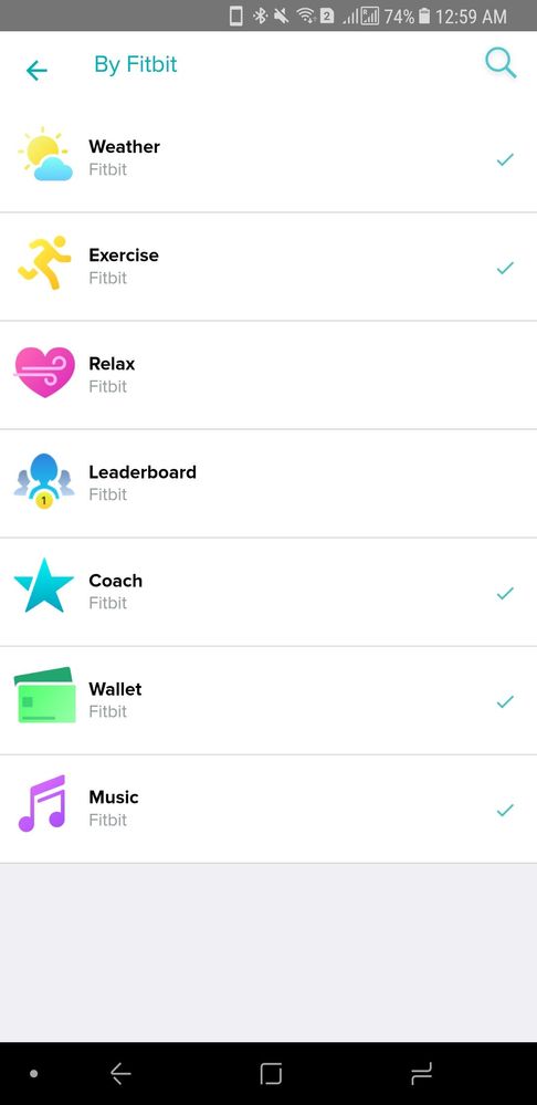

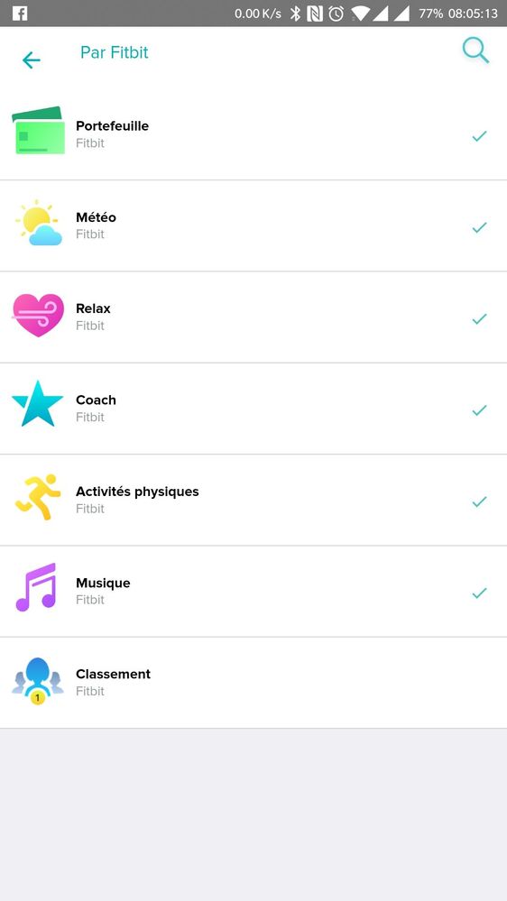

Fitbit Pay is available for every Versa except in the United States (not sure where else this dumb limitation applies - Fitbit you are foolish for doing this) where you have to buy the special edition in order to get NFC functionality for fitbit pay. If you are in the category for fitbit pay on your device, go to the fitbit app store and find Wallet app in the fitbit apps section. Install it. Then, see if it works.
Best Answer05-05-2018 17:03 - edited 05-05-2018 17:04
If you have it, it will look exactly like this on a versa with fitbit pay enabled.

The wallet app is already installed. Tried uninstalling it and putting it back on but still no tile.

Same issue. No wallet tile of the Fitbit Versa page.

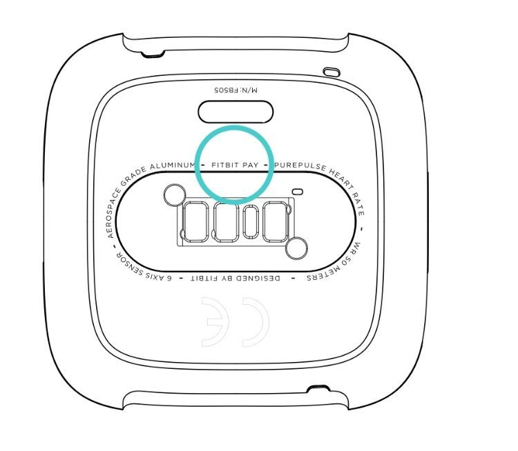

PS: My watch does read fitbit pay at the back so it's clear that I did buy the correct product.

Have you checked if your Versa version has nfc connection ? You can use your versa wallet only if your versa version is available. Check under your tracker the sentence “Fitbit pay”. What should I know about Fitbit Pay?
