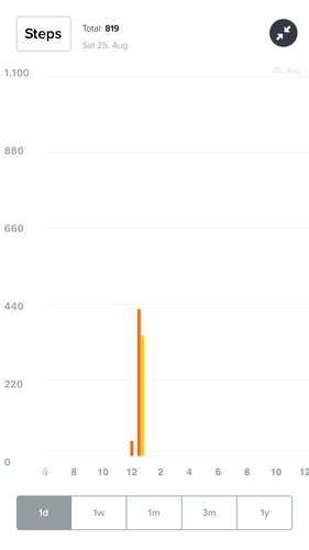

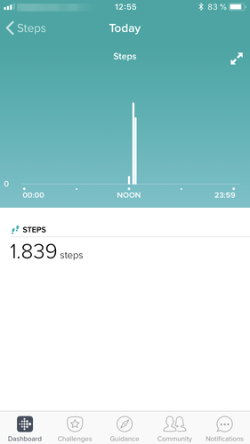

Best Answer08-26-2018 01:42
08-26-2018 01:42
I charged my Versa yesterday morning and i got one thousands ghost steps.
But they didn't show up in the diagram.
