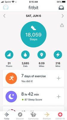

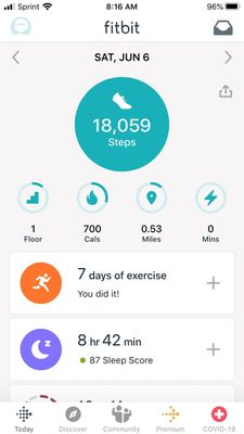

Here is a sample of a previous day's values blinking between actual and today's values for Floors, Cals, Miles, and Mins.
