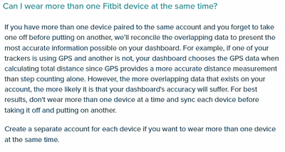

The usual case for using 2 trackers, and what I was assuming you wanted, is to switch between 2 different trackers at different times, such as one for daytime and one for going out in evening, or such. If you wear them both at same time, that will only create confusion. The phone app (and main Fitbit database) cannot keep 2 different sets of data for one account.
This section, just below the link above, explains how it will treat that:
If you truly want to keep 2 sets of data, you do need them to be in 2 different accounts with different emails, and keep logging out of one account and then into the other.
