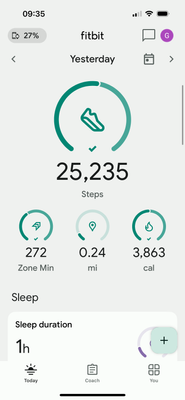

My versa 3 stopped tracking milage a few days ago. If I start a workout like a walk or hike, it tracks the distance in the workout. However, it does not track distance in my everyday walking. This was not an issue until just a few days ago. I've restarted the Fitbit and my phone, but nothing has fixed it. Help?

I'm having the exact same problem.  It's tracking my steps, sleep, heartrate, stairs and basically everything else but not tracking any distance unless I'm using it on a workout.  I also reset the Fitbit multiple times and it's still doesn't work.

I discovered a work around today! If you set your stride length instead of having them estimate it, the milage works again! I found an easy calculator online to estimate it for me. Maybe one-day I'll truly figure it out. But I'm ok with estimating right now.
To set your stride length on a Fitbit Versa 3 using the Fitbit app, you can do the following:
  1. Go to the Today tab
  2. Tap Exercise days
  3. Tap Menu
  4. Tap Activity settings
  5. Tap Stride Length
  6. Adjust your stride length
thank you! The versa 3 is working fine again thanks to your instructions 😀
